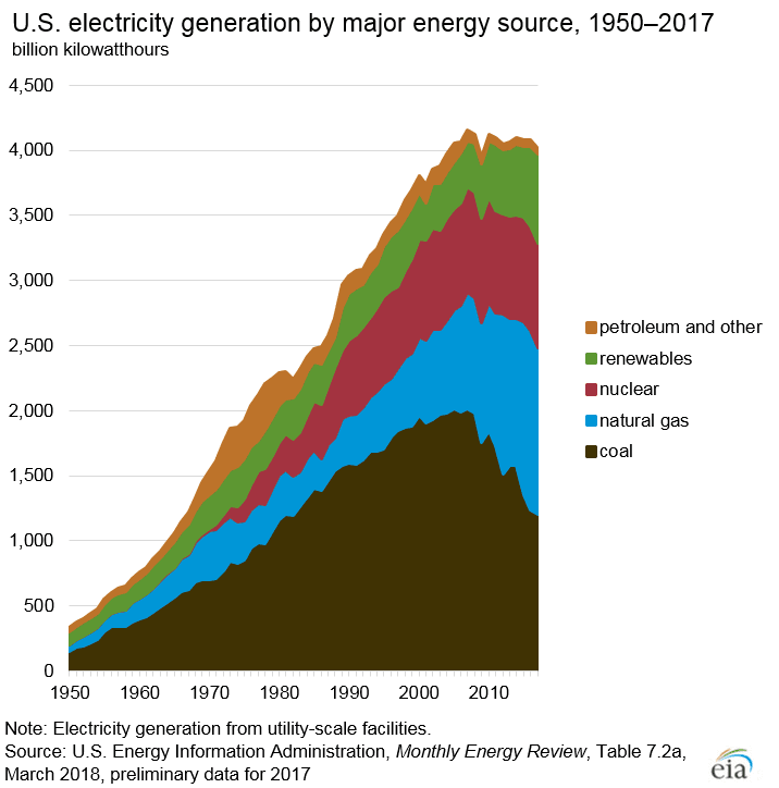

JoshPlum:
5) Coal burning power plants are the worst offenders. I've seen studies suggesting that the quickest and most efficient method to reduce carbon emissions would be to replace coal burning power plants with natural gas powered turbine generators. It's definitely NOT carbon free, but if it is a cost effective step in the right direction then why aren't we doing it?
In the US we are. The wide availability of cheap fracked natural gas has enabled this transition to occur for immediate economic reasons alone. As a result, we have the most significant reductions of CO2 emissions over the last few years of any major country (from an admittedly high starting level).
in my ignorance ... why does burning natural gas reduce CO2 emissions ? 'cause energy/ton CO2 emitted is greater for natural gas than other FFs ? I has assumed all FFs were the same.
I have long wondered why propane is not more widely used.
Natural gas has the highest ratio of hydrogen to carbon of any fossil fuel -- mostly methane (CH4 at 4:1) and some ethane (C2H6 at 3:1). So the result of oxidation is more H2O and less CO2 per unit of energy. The longer the alkane "chain", the closer to a 2:1 ratio it comes.
Coal is much closer to "pure" carbon with very little hydrogen, so produces about twice the CO2 compared to natural gas per unit of energy. Combine this with the ability to use natural gas in "combined cycle" turbines that get 50-60% efficiencies in converting the thermal energy to electricity, compared to typical 35% for coal plants, and you get even greater resulting CO2 reduction. (The "supercritical" coal plants starting to come on line look to increase their thermal efficiencies to 45% or so.)
Propane's ability to compress to a liquid at ambient temperatures makes it very valuable for use where it is not feasible to pipe natural gas. It would be a waste to use it where natural gas would do.
Burning coal, all of the energy comes from converting C into CO2.
Burning hydrocarbons a large part of the energy comes from converting H to H20.
How far changing from coal to methane is a good idea, I'm not sure. A power plant built today is likely to be around for 40 years, so it might be more cost effective to switch to other (non-fossil fuel) sources, even if the total investment/kW was higher.
If there was a realistic price on GHG emissions, the market could sort out these things, but with so much of the cost hidden it requires subsidies and central regulation.
It does seem a bit surprising that it is the more conservative governments in the world who seem to be going for the latter route, but we just have to work within the politics as they are.
