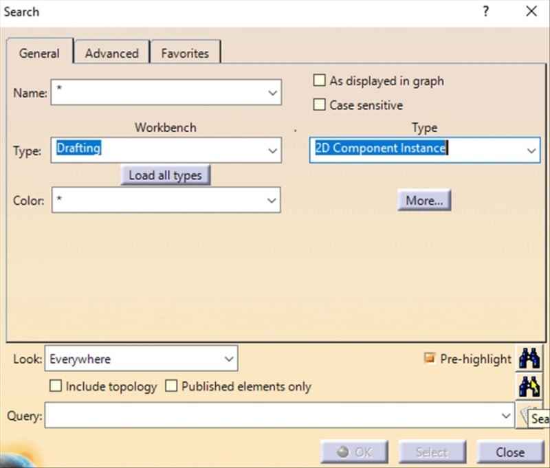

Sep 28, 2022 #1 kdeni Automotive May 9, 2018 5 HU Hi All, sometimes I have to check drawings. I have to search texts on main sheet. I use the Edit/Find... command, but it doesn't work, if the texts are in 2D Component. It is possible to find the texts "everywhere" on the main sheet ?

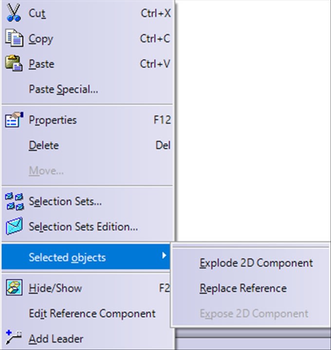

Sep 28, 2022 #3 rickyt Automotive Jun 26, 2002 233 US I think you will need to explode them first, just don't save file afterwards. Use the search command Choose search and select then RMB on one of the selections Upvote 0 Downvote

Sep 29, 2022 Thread starter #4 kdeni Automotive May 9, 2018 5 HU Not realy. I have lot of Texts, Tables, 2DComponents with words, numbers, sentences. I want just find and select a subtext, what I need. Upvote 0 Downvote

Sep 30, 2022 #5 Little Cthulhu Marine/Ocean May 27, 2018 716 RU Export to PDF or any other external format with text and search there. Upvote 0 Downvote
