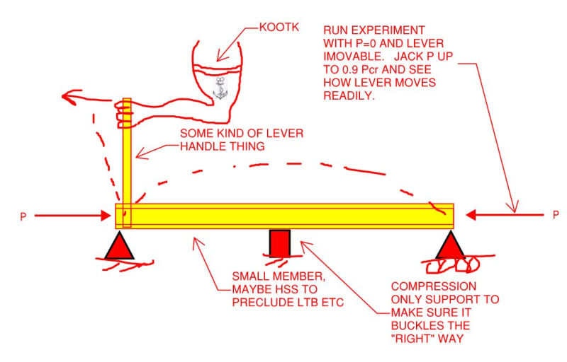

With regard to compression's impact on apparent flexural stiffness, I've always felt that the stability lab demonstration shown below would rock some worlds if it could be set up safely. Heck, if a few graduate students had to perish in the service of scientific discovery, so be it.
Sure. I feel that this would be bloody astounding to feel, literally, in my own hands: the apparent, rotational stiffness of the beam changing with increasing axial load.

Great, it's designed to fascinate and enlighten, not necessarily encourage any one perspective.
One 'tool' I've often used to demonstrate buckling is the inside of a standard BIC ballpoint pen. So I've now spent the last two minutes running your little experiment. The reduction in flexural stiffness is quite apparent both with an end moment and a centre point force.
[2thumbsup]
Does it work? I kind of live in perpetual terror that, push come to shove, it might not.
It works quite well. (The centre point force is not as obvious if you just use you fingers because of the low loads involed but then if you use the outside of the BIC pen as a lever arm it becomes quite apparent.)
Who needs these fancy apparatus when you have this on your desk. It works for the calculations and for the experimental apparatus! :-D
Is it really the case that the flexural stiffness is reducing? I know it feels softer, but isn't that because Axial load P is already loading the beam in a way that will drive the beam into a buckled shape, meaning there's less work required when bending the lever?
Yup. That's the "apparent" in the apparent flexural stiffness that I keep mentioning diligently. E, I, & L obviously remain the same throughout the process. This is, however, precisely the effect that the geometric stiffness matrices are capturing.
