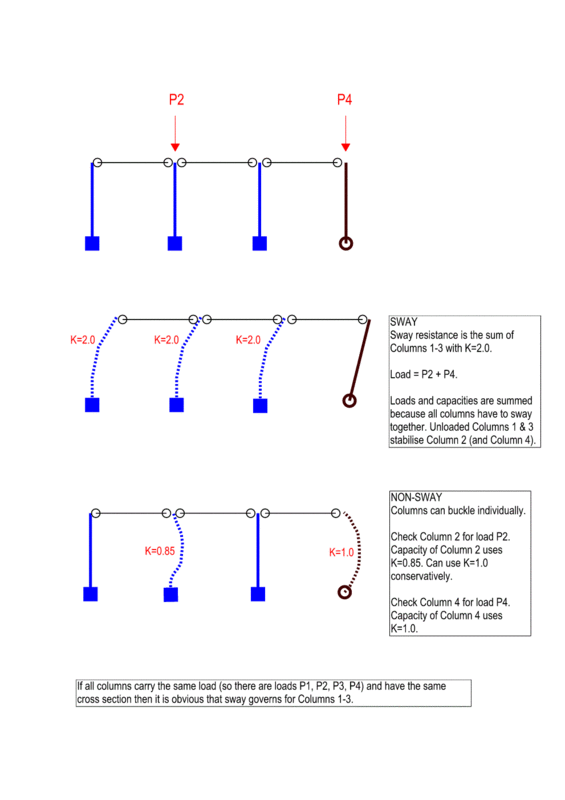

a) Laterally stiff vertical elements such as walls are generally used as the designated lateral system with K >= 2.0 as befits a cantilever.
b) Laterally flexible vertical elements such as posts used in conjunction with stiff walls are generally designated as "gravity only" with K <= 1.0 as befits a member with lateral restraint at both the top and bottom.

Using the effective length method for a member without relative, end to end translation (gravity post) results in [0.5 <= K <= 1.0] by definition. 1.00 represents perfect pin-ended-ness. 0.50 represents perfect rotational fixity. Everything else -- the real world that is -- falls between those extremes.

@lexpatrie Why not <1? Imagine a frame with huge beams and very small columns (frame is of course braced by another stiff member).
These (gravity columns) are typically designed as pin-pin, so K=1, hence my continued complaint about folks saying K<=1.0. It's not meaningfully less than 1.0. You aren't going to have GB = 0 (infinitely fixed base) on anything, a pinned base is GB = 10 in a practical sense, and when the column isn't designed to have any restraint (simple beam connection) there's GT = infinity (in theory) and perhaps 10 in "hypothetical practice", but outside academia a gravity column is K=1.0. You wouldn't normally even "do" a K factor on the gravity columns, you'd use 1.0. Unless there's something really odd going on in typical practice and nobody told me. You won't get much out of K=0.99 versus 1.0.
Ok, fine, let me go get my nomograph from the garage.
1st ed LRFD, "If the column end is rigidly attached to a properly designed footing, G may be taken as 1.0. Smaller values may be used if justified by analysis."
Yeah, 0.85 isn't too far off, with GB = 1.0, GA = infinity. That's an unrealistic design scenario, however, fixed bases at random columns in a building that aren't part of the lateral system are (highly) unconventional. I maintain my point. The infinity at the top is rather dominant and pushes the K factor to the closer side of 1.0, even with a pinned base, GB = 10, the K factor doesn't move that much off from the top end of the scale. Hence, most engineers won't bother/don't bother.

For that second figure, the sway figure, recommended K is 2.1, not 2.0 See Table C-C2.1, 1st ed LRFD (case (e)).

@Lexpatrie I used cantilevers because they're simple. No frame action and don't need the graph for K. OK America uses 2.1. I thought 2.0 off top of head. That was Britain. Australia is 2.2. Doesn't really matter to the principle. You wanted to know when K<1. When effective length is used for sway design (K>1) and you check total vertical load against sum of column capacities AND some columns are heavily loaded and some are lightly loaded then you should also check nonsway for individual columns with heavy loads using K<=1. Sway still often governs.
