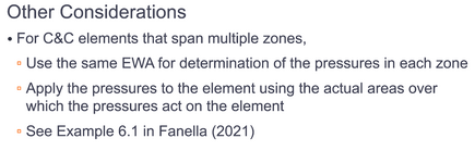

I have a stud wall that bypasses the roof line to form a parapet. Ive been using an effective wind area for the wall based on the overall length 21.1' to get 21.1'2/3 and use this value to get both my wind loads for the wall portion and the parapet portion.
Im second guessing myself and wondering if i need to use the parapet height 7'2/3 to get an effective wind area and a wall height, 14.1'2/3 which will yield a much bigger result. Thoughts?
Normally I would say that the element is the entire stud and its effective area is calculated based on its actual length & span/trib but the parapet presents a different scenario.
How about ASCE 7-22 Section 30.6? And Figure 30.6-1.
The parapet wind pressure is much greater than the wall surface below the roof I think your design should account for that.

And to answer your original question, I have always used the entire height of the stud, including the parapet, to determine the C&C wind load.

Consider Each tributary area separatly.
Parapet has higher wind co-efficients.
