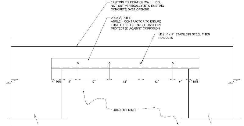

I read through the links you posted and I do not agree that the specific members you mentioned said that you could use a plain concrete beam in contravention of building code requirements. In the first link, XR250 just said to check the capacity of the band spanning across the opening. In the second link, KootK said that arching action might be possible, not to treat it as a plain concrete flexural member. Some other codes might allow plain concrete flexural members for your situation, but if ACI 318 is your governing standard then you probably don't want to violate the code if there are any other options available to you. If you can calc out the capacity you need from some alternative load path like arching, then you are good. If not, then put in some structural members or reinforcement.
Here is a detail that I've used before. You'd need to check the steel angle size and bolts of course

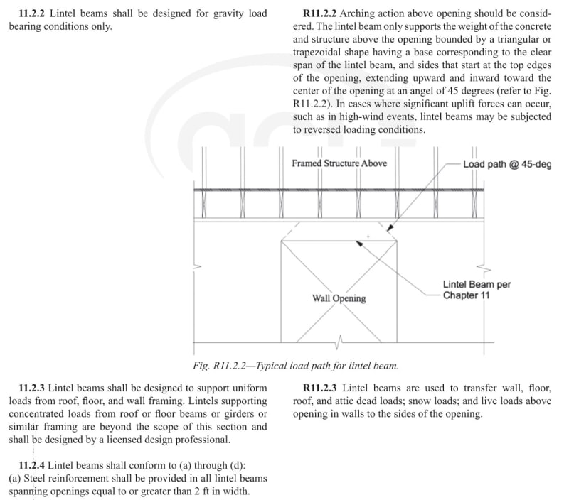

Sokka10, for your additional consideration here's what ACI 332 Code Requirements for Residential Concrete has to say on the matter...
This code may or may not be applicable, but if anything went wrong and you were sued, you might have a hard time arguing that you were following the standard of care by using a plain concrete beam.
