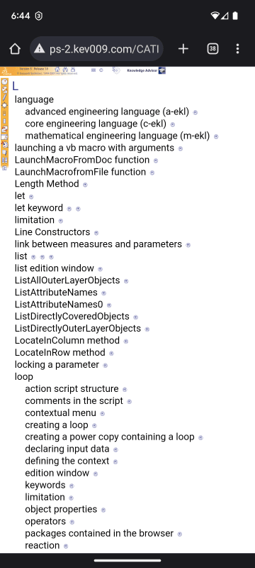

Hi Eric, thank you for your reply!
Unfortunately in V5 we don't have the method that you mentioned. I found this list yesterday in the documentation.
I heard that are differences on how the publication is structured in CATIA 3DX in comparison to V5. Maybe this is the reason you have it, and in V5, we don't.
I am still searching...
Really appreciate you time!

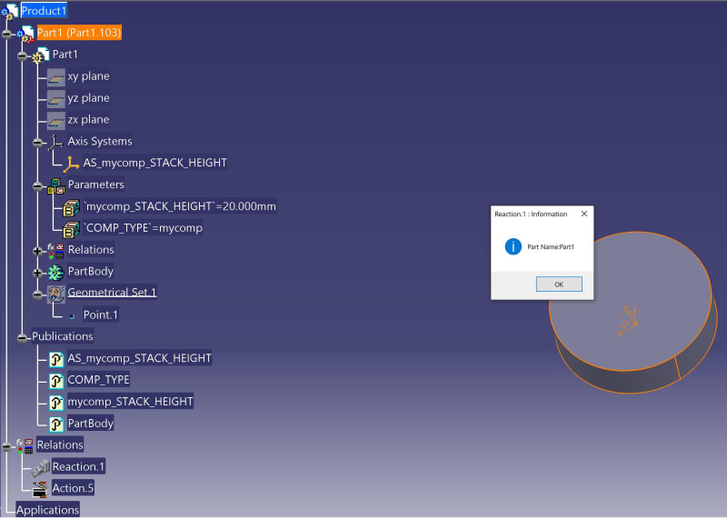

Please see below what I've got so far...
If you add this code to the action that is inside the product...it will do partially the job...I still need to set the value...but this will be tomorrow...or today....I need to sleep...
Code:

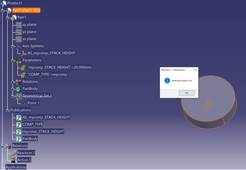

Message("MyProduct:", MyInsertedComponent.Name)
let myPart (Part)
Set myPart = MyInsertedComponent.Find("Part","",true) \"I was able to access the Part inside the product like in VBA...\"
let myPartName (String)
myPartName = myPart.Name
Message("Part Name:", myPartName)
let myParameterSet (AdvisorParameterSet) \"This is how to access the parameter set \"

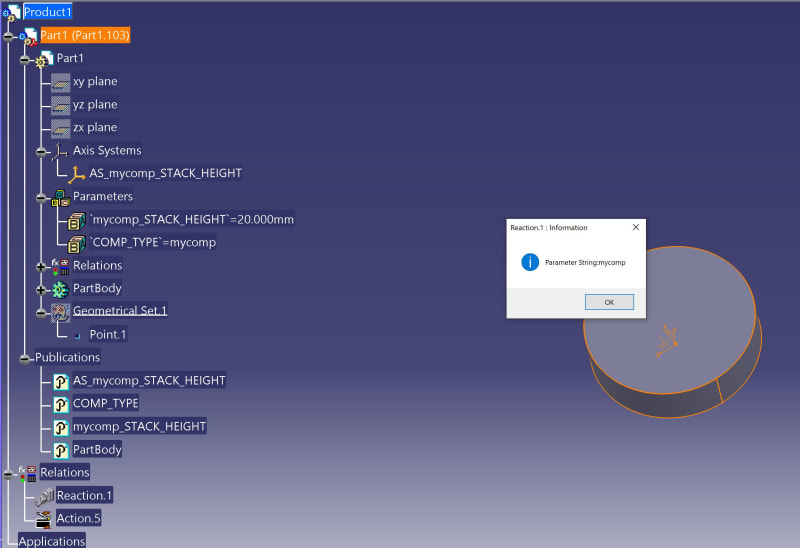

let myParameterString (String)
myParameterString =myParameterSet ->GetAttributeString("COMP_TYPE") \"How to search for a parameter string\"
Message("Parameter String:",myParameterString)

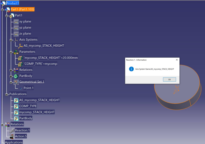

Let myAxisSystemName (String)
myAxisSystemName = "AS_" + myStackHeightName
Message("Axis System Name:",myAxisSystemName)

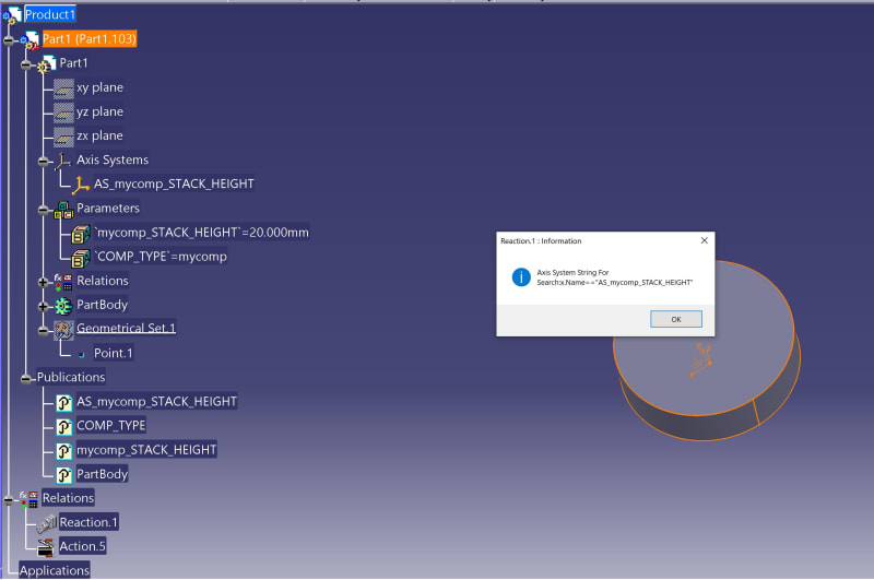

Let myAxisSystemStringForSearch (String)
myAxisSystemStringForSearch = "x.Name==\"" + myAxisSystemName + "\""
Message("Axis System String For Search:",myAxisSystemStringForSearch)

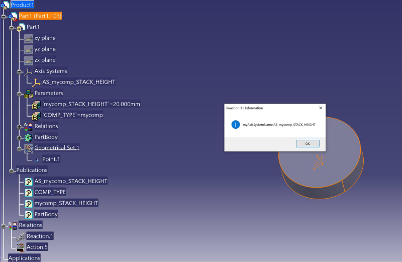

Let myAxisSystem (AxisSystem)
Set myAxisSystem = myPart.Find("AxisSystem", myAxisSystemStringForSearch, true) \" how to get an axis system\"
Message("myAxisSystemName:",myAxisSystem.Name)

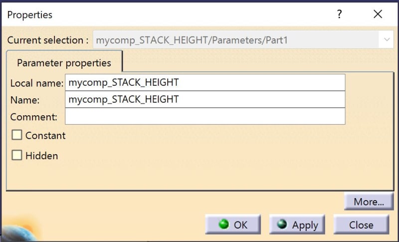

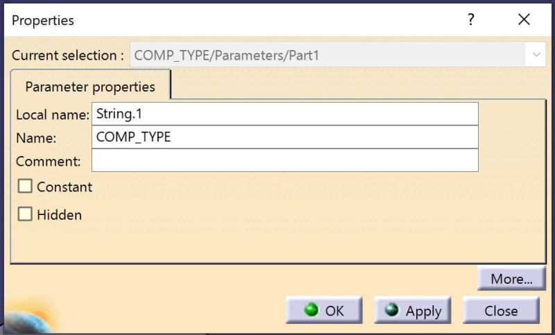

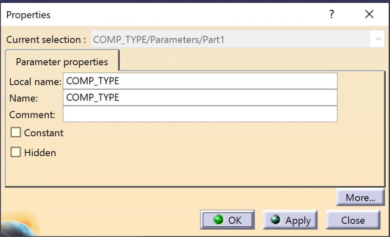

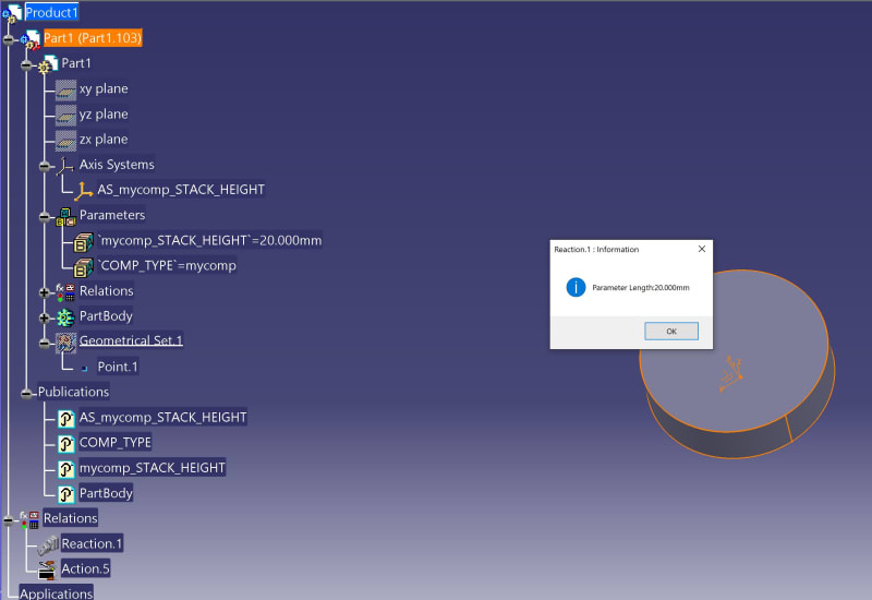

But there is a catch...
you need to right click the parameter and access the Properties panel.
you need to change, [highlight #FCE94F]NOT ONLY THE NAME attribute[/highlight], but also the [highlight #FCE94F]LOCAL NAME attribute[/highlight]!!!!!!!! If you don't, you are not going to find the parameter!
Not going to work(Below)
Going to work
Going to work
Below are the message box from the code:
This is the Product(Part inserted - Instance Name)
This is the Part Name
This is the String Parameter:
This is the length Parameter:
This is to build the string to search the Axis System - first step
This is to build the string to search the Axis System - Second step
This is the Name attribute from the Axis System Object:
I hope it helps.
