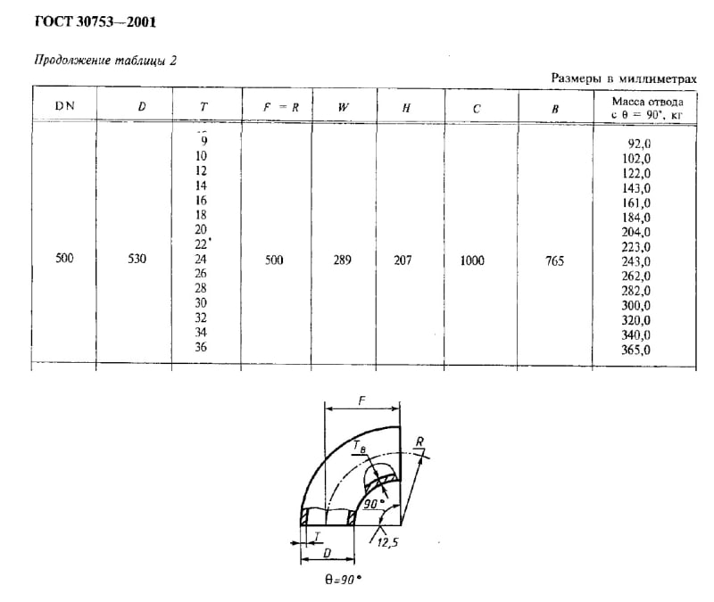

Degraded elbow that needs replacement
OD : 529mm
t: 10mm
(Measurements roughly taken)
I am not well known to this work. I donot find this elbow size in ASME 16.9.

Rough measurements to 1mm accuracy?
Maybe the elbow is from Russia and was built to GOST dimensions.

You've answered your own question. This looks like pipe made to DIN 17175-79 and bent into an elbow shape or made specifically to fit DIN sized pipe.
Hence not an B16.5 elbow.
I can't find a dimension chart for DIN 17195 pipe though.
It's high temperature boiler tube.
Looks like a "special" to me.
