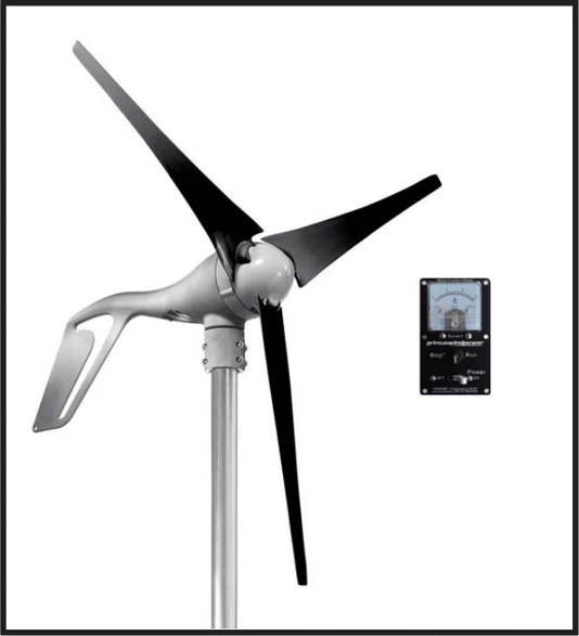

This generator charges a battery bank.
No speed control.
The faster the generator spins, the greater the charging current and hence the load.
The voltage is almost directly related to the speed.
The voltage is limited by the battery voltage and thus the speed is regulated.
When an internal circuit sees an output voltage corresponding to full charge, the output is shorted internally and the generator stops.

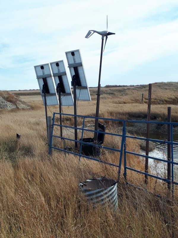

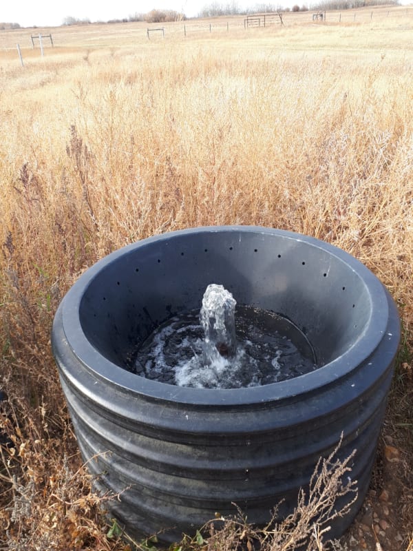

This works dependably every day, supplying power to a water pump supplying water to a herd of beef.
When a proximity detector detects cattle near the water bowl, the pump is started.
Generally, the current draw of the pump will drop the voltage enough that the generator will start spinning again.
The generator is a three phase permanent magnet alternator with an internal bridge rectifier to outtput DC.
Ohm's law
Not just a good idea;
It's the LAW!

1. Load bank. Initially the speed is controlled by the connection to the batteries. When the batteries reach full charge, a load bank is switched in in parallel with the batteries to dissipate the excess energy.
2. Shorting. When the batteries are at full charge voltage, the generator output is shorted internally and will stop.
The generator will cycle on and off depending on the battery state of charge.
I prefer the shorting method. Many less points of potential failure.

I did some trouble shooting on the installation in the first pictures.
The rancher is very happy with it.
The wind turbine and the solar panels are working well together.
He did have a problem with the inverter shutting down on low battery voltage.
He added a second set of batteries and has enough carry-over time now.
The cattle tend to water in bunches and the continued use was draining the battery bank.
There was enough energy available in 24 hours and a larger battery bank gave the carry-over to avoid the low voltage shutdowns.

I wanted to give this a bump to see how things would change if the generator was AC instead of DC. Any input would be appriciated!
Well, unrectified AC won't charge a battery.
But, a DC generator has issues with brushes.
The Primus generator generates three phase AC, avoiding brush and commutator issues.
The AC is bridge rectified internally to DC for battery charging.
As the wind speed increases, the output voltage rises.
As the output voltage rises above the battery voltage, the current increases.
As the current increases, the load on the prop increases.
These factors all work together to control the speed of generator within acceptable limits.
