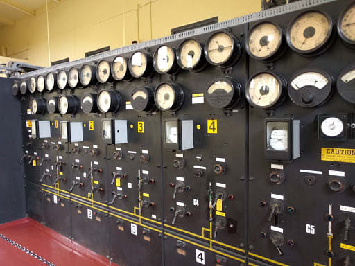

A long time ago, I was visiting a very old hydro plant. The generators were running at about 10% output.
Running at low output is better than shutting down completely. It keeps the alternators warm and dry.
One operator was on duty.
The phone rang.
It was the load dispatch center.
"Please take your sets up to 80% load."
The plant was so old that everything was manual. There was not even an Automatic Voltage Regulator.
The operator turned a switch on the control board.
WE could see on the machine room floor, a very large hydraulic cylinder start to extend and push on a very large bell crank.
That opened the gate and allowed more water to flow through the turbine.
As the output increased without a corresponding increase in excitation, the power factor dropped. (On a stand alone set, the voltage would drop, but when connected to the grid, one set has little control over grid voltage and the PF drops instead.
The operator left the switch controlling the hydraulic solenoid and moved to a rheostat.
He manually increased the excitation until the PF was satisfactory.
Back to the hydraulic control and pick up more load.
Over to the rheostat and increase the excitation.
Rinse and repeat.
It was a unique experience to see operations that are normally done automatically done completely manually.
A few years later the plant was completely automated and there was no longer a local operator. Everything was done remotely by the load dispatch center.
The plant was eventually taken out of operation and became a visitors center.

THE ORIGINAL MANUAL CONTROL BOARD
