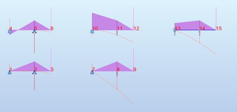

BG1999:
There are a few ways look at this, but I'd say the most realistic is to not think of the hairpin as a hard support point instead it will be more spring like and really just restrain the overall top deflection of the pier so something like a fixed base - spring - cantilever model is probably an ok approximation.
Here are 5 quick free bodies with approximately proportional properties and the deflections and moments plotted:
[pre]fixed-roller-cantilever fixed-spring-cantilever spring/rotational spring - spring - cantilever
pin-roller-cantilever pin-spring-cantilever[/pre]
The spring at the slab is AE/L assuming a 10ft wide x 4 in thick effective beam , 3000 psi, and a 60 ft span
I think I have generally done it the other way. I'd tend to use springs everywhere, but if I needed to simplify I'd be using a rotational spring for the footing base and a solid roller for the concrete tie, and if I was using springs everywhere I'd likely overestimate the tie stiffness to be safe. Taking the base as fixed and the concrete tie as a spring is going to underestimate the load on the tie.
Shallow foundations like this are really really flexible under moment when you start considering the soil and are likely going to move way before the concrete tie does. You'll have a bunch of theoretical capacity in the footing, but you're going to break that tie before you mobilize all of that capacity.
It's annoying, because it's likely that the most efficient way to do this kind of construction is to design the base of the column to take the small amount of moment necessary to put the pin at the base of the footing, but you're never going to get the vendor on board to do it.
TLHS:
Good point, after more thought I would tend to agree that the tie will be stiffer than foundation sliding/passive resistance (silly me otherwise you wouldn't need to use the tie). The foundation rotational stiffness will depend on the footing size but since the PEMBs are all about low cost you'd be aiming for the smallest foundation so a soft rotational spring if used does make more sense.
