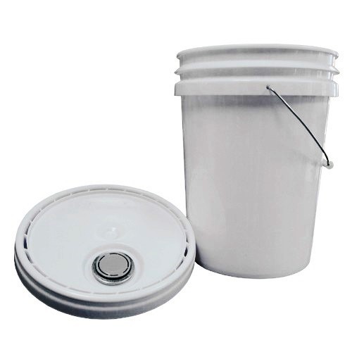

If you search "Quick opening closures" you should be good - the advantages here is that the vacuum applied will help seal the lid - all you really need is some locating lugs and a bit of a weight - some bricks or a person would probably do it if the seal is good enough. The trick is to get the sealing surfaces flat and the lid pretty strong.
Or a simple G clamp - there's bound to be a few of those hanging around
Something like this attached.
And a bin like this

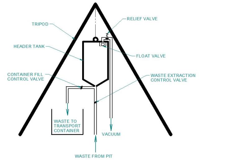

In case it helps, schematic of my suggestion.
Header tank Schematic
It's approximately to scale assuming 6 ft poles for the tripod, location and types of valves I've indicated may not be ideal but I'm not a pump or sewage guy (yeah I know I may be full of it but that don't make me an expert in handling it).
Rough work flow after setting up.

KENAT - Pretty good - I would put the fill line at the bottom of the bucket but otherwise OK, Just add a vacuum release valve to allow the SH1T to flow out and that could work a treat.
LittleInch - sadly if I put the poop pipe down to the bottom of the poop barrel it obscured the poop text.:-(
Good point on the vacuum release valve, simplistically perhaps add manual override to the vacuum relief valve.
Or put separate release valve in equivalent location in the system i.e top of tank equivalent - could be anywhere on the line from the tank to the vacuum pump for instance - maybe the vacuum pump controls already have one in?

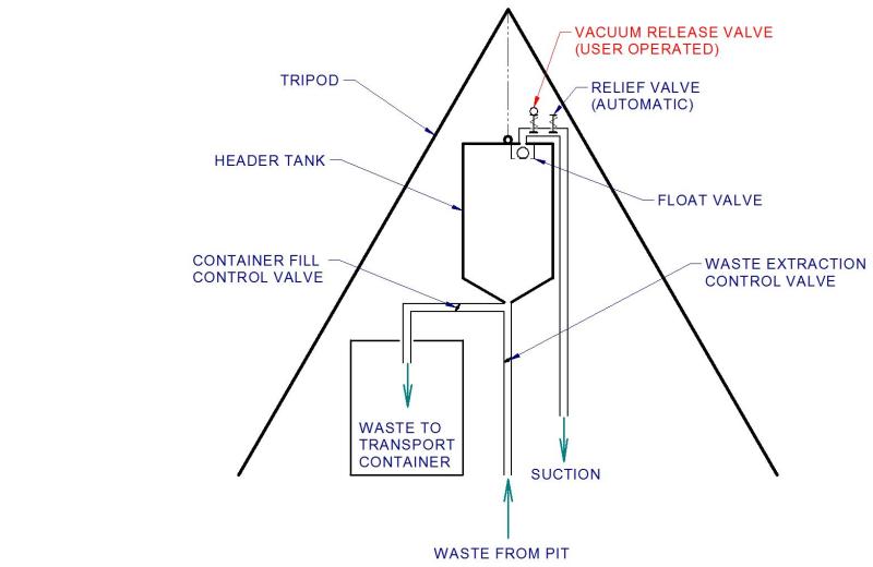

So work flow becomes:
[ul]
[li]Close container fill valve.[/li]
[li]Open waste extraction valve.[/li]
[li]Run vacuum until header tank is full.[/li]
[li]Close waste extraction valve.[/li]
[li]Turn off vacuum (may not be essential)[/li]
[li]Open vacuum release valve (not shown in schematic)[/li]
[li]Open container fill valve & fill container.[/li]
[/ul]

Refined per LittlInch.
[ol 1]
[li]Ensure container fill control valve closed.[/li]
[li]Ensure vacuum release valve closed.[/li]
[li]Ensure waste extraction control valve open.[/li]
[li]Run vacuum until header tank is full/pit emptied whichever comes first.[/li]
[li]Close waste extraction control valve.[/li]
[li]Turn off suction pump (may not be essential depending on power source etc.)[/li]
[li]Open vacuum release valve.[/li]
[li]Open container fill valve[/li]
[li]Fill container to desired level.[/li]
[/ol]
Repeat steps 8-10 until header tank is empty.
Repeat steps 1-10 until pit is empty
Detail design may be able to come up with more elegant valve and piping arrangement or even introduce interlocks or similar to force correct process but I'm an ideas guy not details. ;-)
