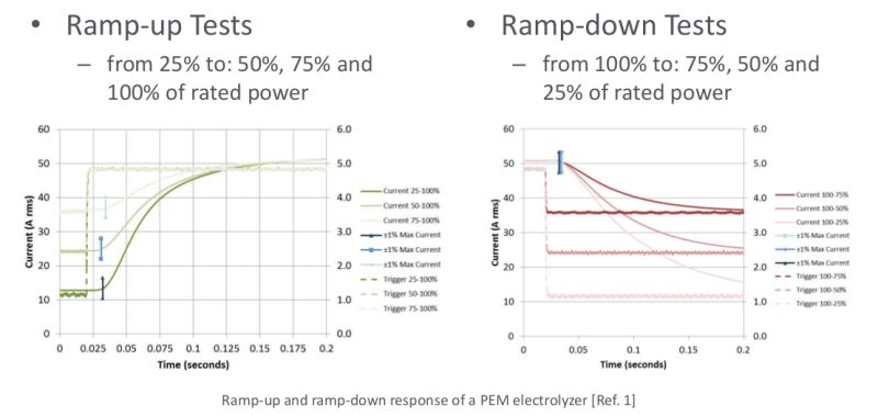

The discussion about fuel cells seems interesting, I poked around and found some DOE test data. I think from this we could conclude fuel cells will often need a storage buffer (capacitor, batteries, or similar) where they are applied to a system where they are the only source of supply.
The complete document is attached.
The document is talking mostly about hydrogen based systems. The ramping rate for methane fueled systems should be similar.
The ramp rates are very much better than I had expected.
That graph is both interesting and disappointing.
The heading doesn't match the graph.
Ramp up test
From 25% to 50%, 75% and 100% of rated power should be,
From 25%, 50%, and 75% to: 100% of rated Amps.
Extrapolating from the graph, it should ramp from 25% to 50% in about 0.05 seconds.
It won't take much capacity to buffer 25% for 0.05 seconds.
Motor starting, the Fuel cells may ramp up into a capacitor that is then used to support the starting surge of the motor, in less than a second in most instances.

Yes! FacEngrPE thanks for the interesting graphs!
I could easily see an automotive solution of simply limiting the drive accel rate to match the fuel cell ramp while as an aside limiting torque-stress to the drive-train (a money saver)
VFD based motor loads would probably be fine with un-supported fuel cells. The speed of ramping seems to make a pretty good case for only capacitor support being needed.
