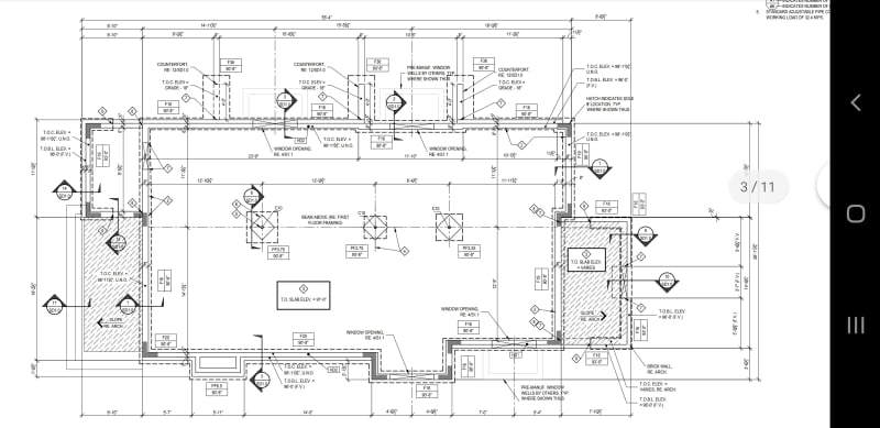

hello guys , this may be a dumb question but I'm going to ask anyway. The engineer of record on a house I'm building wanted a steel beam spliced on middle post with a concrete pad of 24x24" . I built it with a 34x34 concrete pad and just left the post solid because it came that way and seames to make more sense not to cut it , I still supported it on the middle post . Now he is telling me I have to redo it because the pad needed to be 36x36 for a solid beam . This makes zero sense to me but I guess I could be missing something. Beam is 50' Thanks

I apologize if we got into the weeds . I will post the drawings shortly . The pad was originally requested at 24"*24" . My foundation guy always makes everything a little bigger which for the most part I've always been ok with. The main structural beam of the home was designed with 3 post and a splice in the middle . When they delivered the beam it was 1 peice 50' long so I told them to go ahead and put it in solid . The question was more so for my personal understanding of the beam needing a bigger concrete pad on the center post since it was solid then it needed for a splice which I do understand now. However the engineer wants us to either splice it or make the concrete pad bigger by 2"*2" which seemed silly to me. The entire 50' beam has 3 post , 1 every 12.5' all requested at 24"x 24" but were poured at 34"x34" .The EOR requested the center be 36*36 if we wanted to used a solid beam. I'm more than happy to splice it , that is the way it was drawn I just like to save my clients a little money where possible and my welder isn't cheap.

So the beam was designed as continuous over the other posts, and they were designed as 24x24 footings? Now I’m really confused...
Edit: ..confused as to why a 34x34 is inadequate if 24x24s were adequate for continuous supports.
All post were designed at 24*24 . Spliced in the middle continuous over the others. My foundation guy pays for the concrete overage , he makes things bigger just to be safe. If there are any cost that the engineer I cover them. But that's none of the concern my point was why 34*34 wouldn't be sufficient if 24*24 was sufficient for a spliced beam. That's all, again it was more for my knowledge not to get in a pissing match with the engineer we will of course do whatever is asked , I made the decision to go with the continuous beam I will cover cost , as if any of that matters to the question.

I'm in agreement with the other opinions on here that you should probably go straight to the designer or a head engineer and fight this one because the increase in footing size doesn't seem to make much sense. That's a much larger foundation, for the relatively smaller increase in reaction.
Yes sorry I have both my boys and was trying to voice text this and just confused everything. The beam is 50' , 3 post, 3 footings ,specd at 24*24, poured at 34*34
I was just trying to figure out if I was out of my mind for thinking that was way over kill regardless if he's trying to do it just to prove a point because we changed the design. Which is understandable because he drew it a certain way and we changed it
Yes way overkill. To repeat JLNJ said, it only increases the reaction by 12.5%. However, why not ask the question (RFI, etc) prior to making the change to avoid all this mess? This seems common in residential construction; make the change, then ask if ok after.

I'll take a stab, first off it seems more of a pissing match than anything - except that the engineer did (I assume) recalculate to come up with 36x36 instead of 34x34. It sounds like you already poured it so I would wonder if they knew you poured 34x34? I don't know how you would add 2" more concrete to the side and have any hope of pinning such a small amount to the existing. Might be worth going a measuring the actual footer size to see if your contractor poured it larger than 34x34.
The spans aren't equal so it may be a situation where they are trying to even out the bearing pressure in order to avoid differential settlement between footer and wall? Zooming into your drawing I see all three footers look to be a different size. This would seem to confirm my theory that the size is more about maintaining similar bearing pressure than actual size. Changing from two span to one span would also change the load distribution and the footing size.

Let's do some math. Note the dimensions may differ due to difficulty in reading the plan.
Tributary area of the larger support on the left A1 = 12*12.5=150 SF, the middle support, A2 = (6.25+4)*12 = 123 SF
Assume 150 psf load, P1 = 0.15*150 = 22.5 kips, P2 = 0.15*123 = 18.45 kips
It looks like the middle support pad is 2'x2', back check the bearing capacity for axial load only, fa = 18.45/4 = 4.6, say 5 ksf
Thus the required pad for the larger support Af1 = 22.5/5 = 4.5 SF
It seems the 3'x3' pad size is excessive without moment at the base. But...I won't bother with a mere 2" deviation, and I believe the EOR thinks the same, but communication is the key.
