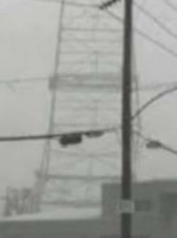

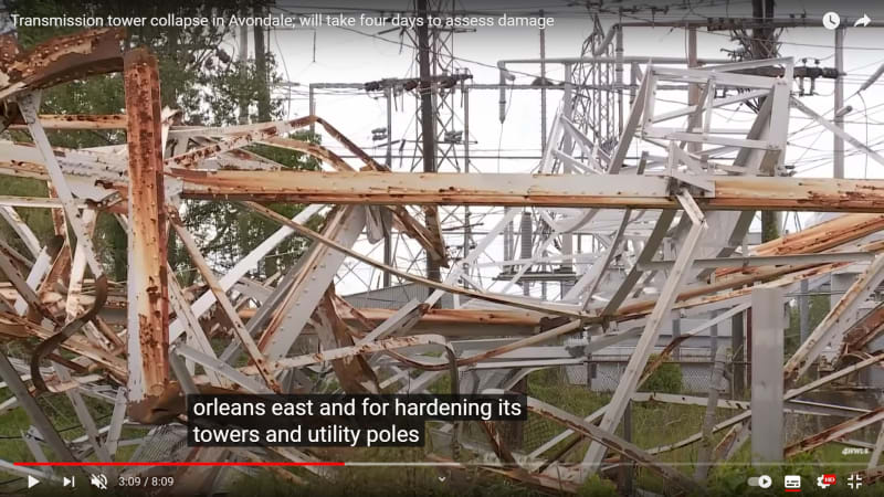

I think we can see the tower failing in this photo. Something doesn't look right at the bottom. Perhaps a twist is underway?

At 150 mi/hr winds, I can see the wind exciting resonance in the tower or the connected cables. Those additional loads are difficult to quantify. The wind design (ASCE-7 risk category III) is 153 mph.
[URL unfurl="true" said:
https://asce7hazardtool.online/[/URL]]Value provided is 3-second gust wind speeds at 33 ft above ground for Exposure C Category
The 100 year MRI value for this location is 119 mi/hr.
Hazard Category IV only takes the 3 second gust to 158 mi/hr.
A requirement to resist rotational winds (tornado crossing the center line of the tower) is not discussed in the standard, but is possible to encounter. Rotational winds at the top of the tower might not be visible from the ground.
While the tower did collapse, it did - at least for a time withstand extraordinary conditions.
Could age have weakened the tower? It survived Katrina.

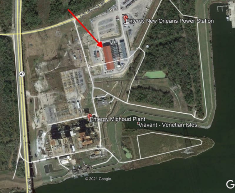

Looks like the plant that did is a new gas plant:

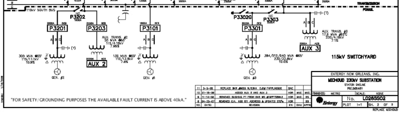

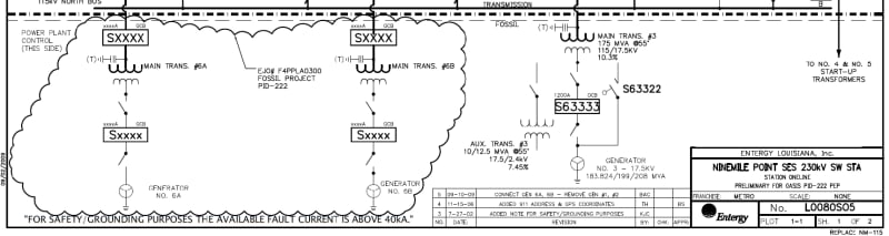

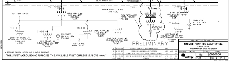

Looking at old public docs it appears like Michoud (shown just to the South) has 3 GSUs rated 300MVA, 135MVA and 640MVA.
Nine Mile has at least one 208MVA and two 870MVA rated generators.
This does not count new generator add-on. So we are looking at least 2,500MW of power right there, taking into account additions and new generation we are looking at upwards of 4,000 or more MW of power. A strong Island is diffidently doable.

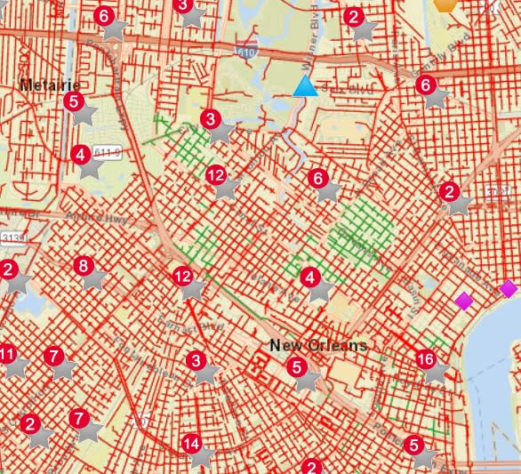

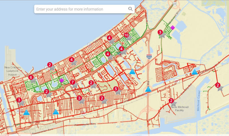

Looks like it worked. Outage map is now showing some green in East and Central New Orleans:
I'm guessing Derbigny and Curran Substations were energized with the 230 kv lines out of Michoud.

Alright, it looks like the were able to blackstart the East New Orleans generating station (Michoud)? and restore a few customers.
They may have used power from the Slidell area to start the NOPS in New Orleans East. There was a lot of talk on about Wednesday or Thursday about bringing power from Slidell, but cagey Entergy was unclear of where it was actually going.
I'm not sure if they even have the capacity to blackstart at NOPS, even though that was part of the design proposed when the plant was presented to a NOLA city council vote. Hearings will be held to get some answers after this state of emergency is over.
Not sure what you mean by this, but the Michoud plant was decommissioned in 2016.
Turns out the green on the map does not even mean that the households in that area have power. A reporter checked it out.
"Entergy officials confirm inaccuracy of power outage map, cite 'communications issues'

I don't know why that transmission tower collapsed. [Heavy sarcasm here]
It was supposed to be painted, but zoom in to the upper left.
