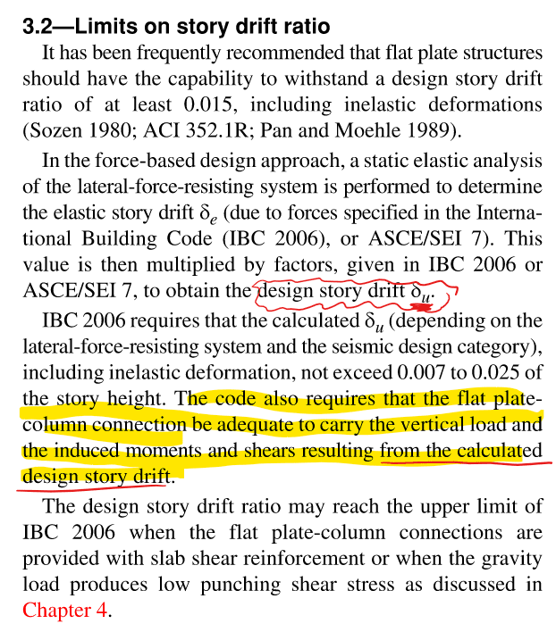

Thirdly, in the example attached, one thing that makes no sense to me given I don't practice in the states and are not really familiar with the inner workings of US loadings codes, is that they are checking this column/slab connection for 2% drift but then they come up with 0.75" drift when the elastic drift or compatibility drift this connection will see will be 2% x storey height of 12' = 2.88" drift (i.e. same as shear walls in building). Why is the drift being reduced, seems illogical to me if the floor system is going along for the ride to 2% total drift as stated? For example they are stating at 0.75" drift these upper limits are not applying, but they sure as eggs will if you push it to 2.88" drift...
Thanks for any input!
Yeah I have the 2010 version, but up until a certain point in the standard it's talking about delta_u which is the total drift that the connection undergoes. Then all of a sudden it just says we only need to check the elastic part which is fundamentally incorrect as the frame goes along for the ride to delta_u. Evaluating the design actions at delta_e is not correct in my mind.

On the drift I agree that the frame will go along for the ride, but in ASCE 7 the inelastic drift, delta_u, is found by amplifying the drift obtained by an elastic analysis by a Cd factor. The example appears to be reducing the 2% ultimate drift to what the equivalent elastic drift would be by reversing the ASCE 7 procedure, so the analysis procedures are in line.
FYI Example 5 is Example 1 worked in SI units.
I get what's going on regarding the ductile response of the main structural system and how delta_e and delta_u are related by the equivalent of a, ductility factor.
What I have a problem with is capping the design action in the secondary gravity system at the delta_e values for the main structural system. As it is flawed when secondary system carries on deflecting and eventually is limited by the upper limit of the slabs yielding as described in section 6 (from memory). Shows a fundamental lack of capacity design principles.
To throw some numbers at it to demonstrate, let's say the slab/column interface reaches the upper limit design actions at a drift of 2", but delta_u = 3.85x0.75"=2.8875". Therefore assessing the strength aspects for punching shear and shear reinforcement at a drift of 0.75" is flawed because under an ultimate limit state event in which the main lateral system reaches delta_u the secondary gravity system is still elastic up to 2" drift at which point you should actually be assessing the strength limit states for the secondary gravity system. So in the example quoted originally the strength should be assessed at the upper limit strength, not at the arbitrary 0.75" 'elastic' drift limit because the design actions keep increasing past this point until either the main system hits delta_u drift or the secondary gravity system hits its yield limit of the upper design limits.

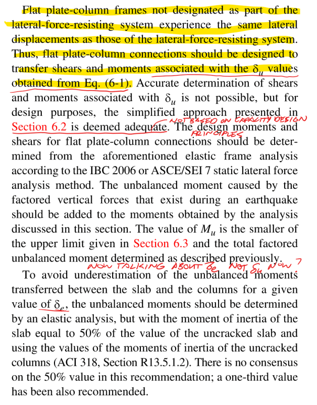

Celt83, just to follow up, if you refer to following extracts. This is basically saying what I am expecting, slab/column interface needs to be designed for actions resulting from achieving the design storey drift (delta_u).
But then later on in section 6 it reiterates this, and then in the following paragraph seems to move towards only checking delta_e drift which is just some arbitrary level of load as the true ductility factor for the main lateral system and the slab/column system could be quite different?!
I don't really agree that it is hard to estimate the moments and shears, in the case of the method presented it will be the upper limit actions unless the slab analysis results in a lower value at delta_u drifts. This is simply recognising that when the main system is at the full delta_u drift the slab is either yielding or its not. Capping this check at the delta_e drift is flawed in my view and could significantly underestimate the design actions for checking both the slab and columns. For example what if at delta_e + 0.1" drift you suffered a brittle punching shear failure. To get to delta_u drift as a system the slab/column interface needs to push past delta_e drift level.
