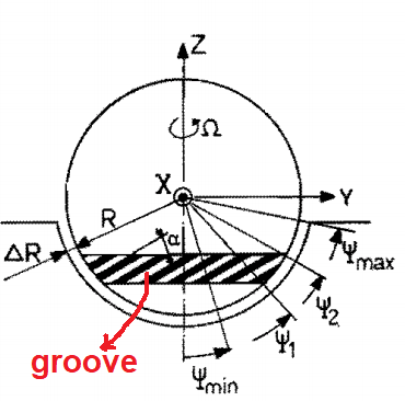

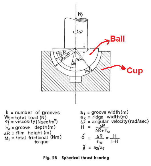

I am simulating a spherical grooved bearing….e.g. A bearing that has spiral grooves on the ball. Please see the following figures.
There is a kind of lubricant between ball and cup, so as to prevent metal-to-metal contact (Full film lubrication theory). The dimension of groove and gap between ball and cup are in (mm) and (micron). For example, Value of groove depth is equal to 0.006 mm and also, areas of some surfaces are too small.
