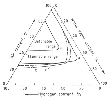

dang, that's not good. I guess hydrogen mixing with air can result in either explosion or fire, but I'm not sure what determines which one occurs (explosion, fire or both). This looks more like an explosion than a fire from the photos. When we had a hydrogen event at our plant due to a hydrogen seal problem a few decades back, it was a fire (I guess seal oil might have been involved in the fire as well, I'm not sure)

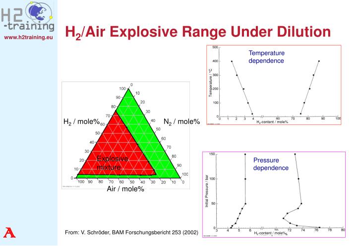

if a purge is done correctly, there is little delution of the h2 purity. the co2 is admitted at bpttom and h2 vented out top. given co2 is heavier
given its been 15~20 years since i worked, but I seem to recall seveal volume changes are needed with n2, only 1 if co2 is used n2 being lighter than co2
