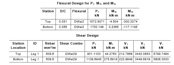

I might have read this wrong years ago, but I believe ETABS:
1) plots an interaction diagram (P vs M) for the wall
2) plots the various loading points
3) draws lines from the origin through each point to find where the line intersects with the interaction diagram envelope (interpolated between diagrams if biaxial bending present)
Where the point falls along the line between the origin and the diagram envelope is the utilization ratio, which is what I believe ETABS reports for the design check ( >1 means that it is beyond the envelope of course). If you go to Design -> Display Design Info -> Right click on the wall, then the results will tell you which load combination it has determined to be the worst case for flexural and shear design (similar to below).
