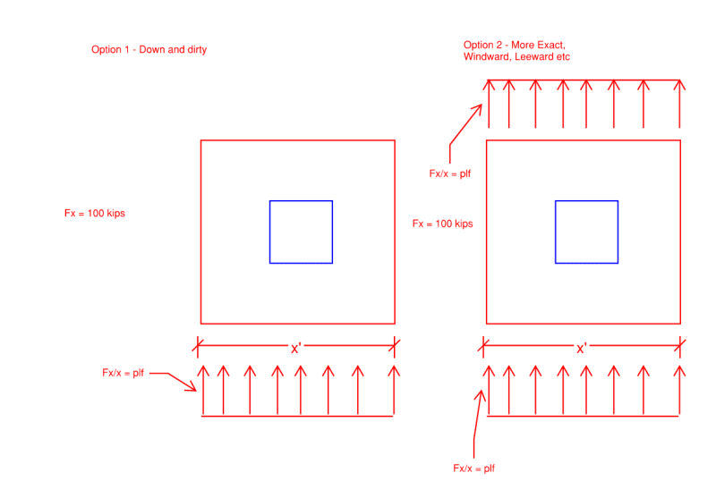

If you put in a single point load, yeah you will get some odd diaphragm results. If you make a rigid diaphragm, you get no results in your diaphragm.
If you have wind tunnel loading, you can make your input in ETABs as detailed as you would like. If you want down and dirty, apply the load to one side of the building. More exact, maybe play with breaking it into windward, leeward and sidewall pressures. See below.
You can modify the applied loading as well to be a trapezoid to achieve Mz forces.

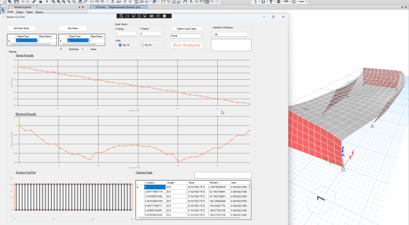

Also, you could take the section cut tool for a spin, it was meant to help review diaphragm shear and moment results in etabs.

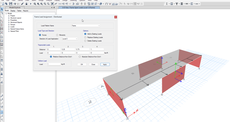

If you have your semi rigid diaphragm modelled with enough sub-divisions, I feel like this is a non-issue. I typically model a frame element with very low stiffness along the edge of the windward/leeward edge of the building and assign a frame load to mimic the calculated wind pressure load. This frame member is then meshed with the semi-rigid diaphragm to get a close approximation.
CSI said:
It could be also more problematic if the user load falls outside of the slab edge or within an opening
I'm not sure what they are trying to get at here. Of course, the user defined load should be modelled where the engineer expects load to be.
CSI said:
Our developers are aware of this item to find a better way to handle user loads with semi-rigid diaphragm in future release of the program.
What is the issue with applying user defined loads to semi rigid diaphragms? Did they explain any more regarding this? It seems to work for me.
Sample, frame with user defined load on semi rigid diaphragm:

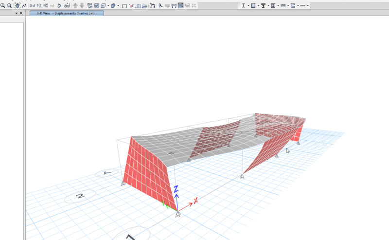

Deformed shape:
Section cut results:
