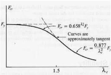

Euler buckling doesn't "cap" at the squash load (where the full section reaches Fy, i.e. P = AgFy, that's another way of restating what 271828 said. It's really more of an energy method, it's going to give you a failure load, but it's an upper limit, at best. It's presuming a deflected shape (a sine curve), and doesn't account for residual stress, out of plane, or initial out-of-plumb, or full section yielding. It presumes elastic buckling occurs.
So it will give you a "correct" answer if none of those items are influential, so for say, Kl/r of 200 it's fairly correct.
When you get into intermediate/short columns the formula is still "valid" but it won't control. Plastification effects (inelastic buckling), tangent modulus, dual modulus, or section crushing (short column) will control before the Euler buckling load is achieved. It a multiple choice situation it's probably safe to cross off any option that's higher than the euler buckling load, provided they don't do anything tricky with bracing or effective lengths.
There's a 0.877 on the Euler buckling load in AISC, if you look far enough back.
AISC Flexural Buckling Equation
