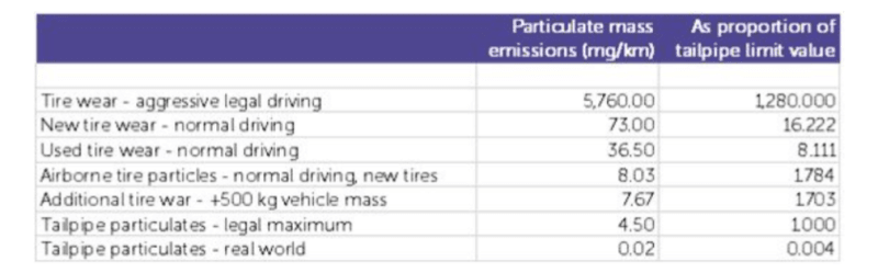

Here is the actual source article, which contains a good explanation of not only what the original intent was, but also how it has been misinterpreted.
The real point is that exhaust tailpipe PM emissions in the EU, which has regulations for this, are basically irrelevant compared to PM emissions from tire wear. There was no measurement of tire wear on a representative BEV compared to a comparable petrol vehicle. The article made some logical inferences based on vehicle weight (the possibility exists), but no actual measurement.

Shoot, I wish I had posted this instead of the news link. This has real numbers (quantities).
Yes, the news article is comparing tire wear to tail pipe emissions. That's not fair because both EV and combustion powered cars have tire wear.
However, in the improved link the tire emissions were measured to be 8.03 mg/km. Adding 500kg weight to the car nearly doubled the PM with an additional 7.67mg/km.
For comparison, tailpipe PM was measured to be 0.02mg/km. The correct conclusion should be that EV's likely emit double the PM (8.05 ICE and 15.70 EV) of a ICE driven vehicle if we assume the EV is 500kg heavier than its ICE equivalent.
Further correction? 7.67 mg/km... not kg?
[Now fixed in post above]

Their tire wear measurements were based on tests conducted on one vehicle, stated to be a Mercedes C-class, presumably a fairly new one. Those weigh about 1600 kg.
So ... how does a +30% increase in vehicle mass (+500 kg) result in a +90% increase in tire wear?
Probably ... because the tires and wheels and car remained the same and inflation pressure presumably remained at nameplate, and the tires are thus operating close to the upper bound of their load ratings as opposed to the lower bound. And the suspension would be riding at a lower ride height, probably affecting the alignment a little. The tires will be flexing more, running hotter, scrubbing more against the pavement due to the increased deformation around the contact patch. I can see that leading to an out-of-proportion increase in tire wear with the same vehicle and same tires and same inflation pressure.
So ... What happens to the tire wear if you accept the increase in mass as part of the vehicle, and re-specify either the tires or the inflation pressure or the suspension settings and/or ??? so that the combination is reset to the best combination for the new loading situation?
My Bolt came with low-rolling-resistance self-sealing Michelin tires with the highest specified inflation pressure of any car I've ever owned.
Maybe there needs to be some clarification.
The baseline weight loss was 36.50 mg/kg. Of that 8.03 mg/kg became airborne / was sub 10 micron. The question is whether the 7.67 is the tire weight loss or the increase in PM? If it is tire weight loss then that 30% increase in weight corresponds with a 36% increase in wear. That seems reasonable, no?
If the 7.67 mg/kg is only airborne particles then that would be a 95% increase in PM. The language makes me think it's the first case, though.
However let's assume the same ratio becomes airborne. 8.03/36.5*7.67 equals 1.69 additional airborne mg/km.
That means the EV makes 9.99 mg/kg PM while the ICE is 8.05 mg/kg. That's stil 24% more PM from an EV vs ICE.

In the tire PM study the total quantity was separated from the airborne emissions. Airborne was 23% of total. Is the brake study airborne or total? I haven't figured that out yet. It seems like brake emissions are minimal except for city driving.
