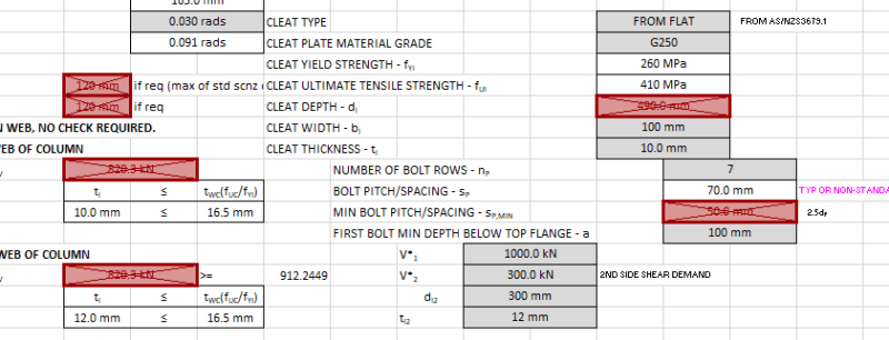

In my case, evil is the headaches in reviewing spreadsheets created by persons not so sophisticated in presentation, that leads to a lot of guess works, misunderstandings, and wasted times. Though commercial software makes mistakes too, it will likely be caught and made known very quick by the purchasers due to the large user pool and daily uses. However, the privately developed spreadsheets usually do not have that level of review, uses and scrutiny, thus user beware.
I used mathcad 14.0 exclusively, hated mathcad 15, then switched to Smath a couple years ago.
I peer review a lot of calculations, and cant believe how many engineers still do hand calcs or use excel sheets.
Its impossible to really review an excel sheet unless the raw sheet is provided (most engineers wont release their sheets to a peer reviewer).

We had a very energetic guy who set up calculations for certain common applications in our industry. He used Excel with visual basic. The calculations presentation look like what an engineer would do, except a lot neater. They're similar to TEDDS, except more industry specific. It was an amazing amount of work.
Some of the techniques he used to avoid the Excel pitfalls were:
[ul]
[li]The programs were locked solid and only he had the key. There was and still is a bulletproof firewall. He's retired, but editing permission is still tightly controlled.[/li]
[li]It was a strictly a fill in the blank program. Loads, length, bracing.[/li]
[li]You didn't save anything. You ran the application and printed it (either to the printer or to Adobe). You could not save your work. These were one off type programs (a steel beam; a CMU wall; etc.)[/li]
[li]The department split up and vetted the programs.[/li]
[/ul]
We still use the programs. It's a job to update them with the latest codes, but most of the time the older version of the code is fine. The senior engineers kind of police the newer engineers using them. I want to make sure they understand what they're designing before giving them a black box.

Yeah, I created a number of macros that use cell highlighting to identify which cells have hardcoded constants in formulas, constant in cells, cells that have conditional formatting, cells that have data validation, cells that have array formulas, non-blank cells, etc. All run from an add-in on the ribbon, you can toggle the highlighting on and off at will. Very useful to me at least in dissecting others spreadsheets and identifying fopars such as hardcoding variable constants in formulas.
Using named ranges in excel can make cell formulas much easier to read and backcheck.
If you're not doing this, you're not using Excel right....

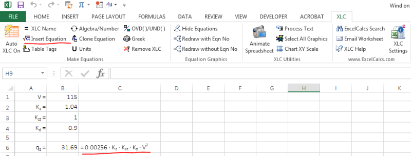

I find the easiest is to develop a function for your equation in the VBA interface as this makes it easier to troubleshoot...
Definitely, the other thing this helps with is if you did make an error, you can basically update it in the VBA and it will obviously reflect through to any cell that uses the function. Rather than playing wack a mole trying to find the error in numerous cells with similar equations.
Don't underestimate the power of some beautifully written comments documenting the code.
The re-useability aspect and maintainability aspect of doing it this way is also a no-brainer to me.

Make use of dynamic array formulas for repetitive calcs. Then you're only updating one equation (as opposed to dragging formulas around to repeat the calculation.
I have a personal setup where each spreadsheet in a template directory has an MD5 hash, so we can tell if someone inadvertently altered the original template. I also implement version control, having a master spreadsheet that is queried each time someone opens a spreadsheet to ensure you know when you are using an older version.
Similarly, I use GitHub to store all the spreadsheet templates with the VBA code automatically extracted via some code I wrote see here and here for the code.
Additionally, we lock the VBA down so no one can access it to make unauthorised changes, the spreadsheets are also locked down to our own network. Open one off network and certain things just won't work, and in some cases the file will be killed.
I find the person who wrote the spreadsheet is generally the best person to check it, check as they go. Produce some independent calcs to cover all outcomes, you check these, spreadsheet follows these. Usually this highlights either an error in the spreadsheet or the hand calcs and you investigate and correct. This serves as a permanent verification record, and also provides examples people can learn/understand what is being calculated. It also helps if you need to modify a spreadsheet at a later date in some instances.
Don't underestimate the usefulness of the built in spreadsheet compare program that is sitting in the excel install directory. It's super useful for checking changes between two spreadsheets.
Make use of the trace dependants and precedents tools, they are super useful for tracing how the calculated cells have been pulled together.
