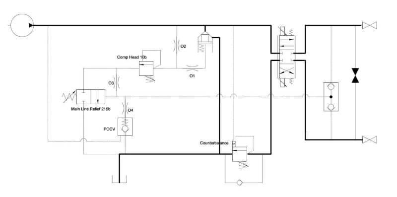

This is right at the opposite end of the complexity and cost scale. The isolation valves on the right hand side supply the rams in a precision motion control application. The application features wide ranging load and speed requirements, but the rams never need to see full pump flow.
You'll see that the proportional valve is closed-centre, so most of the pump delivery has to go through the cartridge valve at the top of the drawing. That valve opens to dump as much of the pump as necessary to restrict the system pressure to the "right" value - "Right" being whatever's coming out of O1.
That pressure can be one of three things.
If the proportional valve is closed, then the entire pump output goes through the cartridge at 10 bar.
When the proportional valve opens, the tapping from the load lines increases the reference pressure, providing a system pressure that drops 10 bar across each edge of the proportional valve, independent of load (which is brilliant if you want a system where flow for a given proportional valve opening is virtually constant). As a final bonus, the main line relief (which is only a diddy little thing) will limit system pressure to 225 bar (though to my mind, it's too complicated an arrangement for you to be able to rely on that feature as a safety relief - I've seen a single component failure on this block push the system pressure up to the point where it blew a hole in the side of the pump).

zeusfaber said:
hydraulic schematic
So if I have a 10 GPM gear pump, and I want 7 GPM to the cylinder, what will the pressure be on the pump side of the DCV? Assume no plumbing pressure drops. Say max allowable system pressure set by relief valve is 3000 psi.
