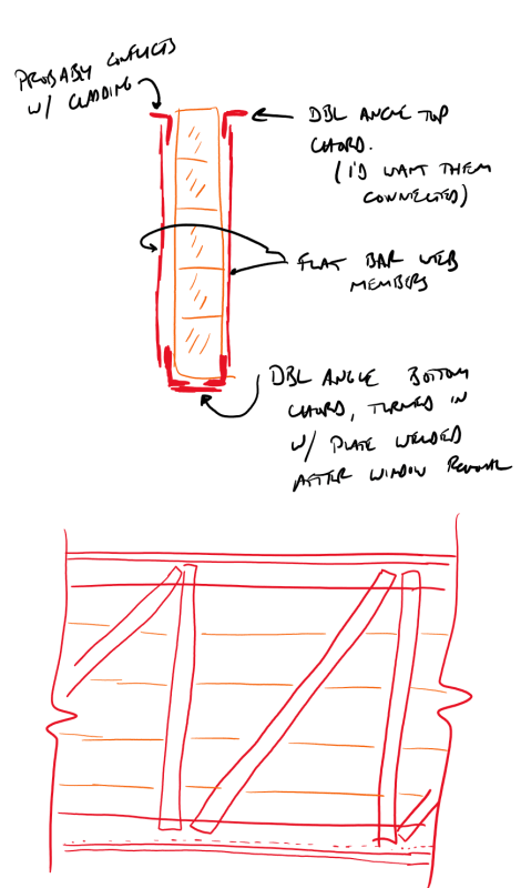

In that case, can you work a steel angle in between the glass block and the head of the window? I'm guessing not, but if you could maybe there's a way you could put one in from both sides and then use flat bar to weld up a truss in the field on both sides. Can't say I love it, but it could work...

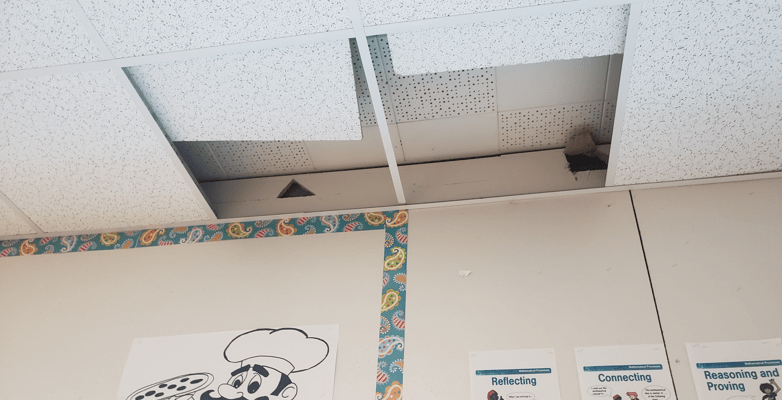

Definitely a neat idea, but that kicks me back to needing to get to the roof level framing which involves abatement. Pic below shows the old ceiling on top of the new one. I've been told that according to the designated substance report it contains asbestos, and since this is a school you would definitely be into type 2/3 abatement. And if that is the route we travel I think we all agree CFS with block removal is the way to go. Wouldn't be that much more to go full monty. With the CFS route it is also possible to do removals / install entirely from outside and perhaps eliminate abatement needs...though would not bet on that.
I do agree with everyone that it only makes sense to do it the CFS way. The assembly is absolutely horrid (as it is) from an energy efficiency perspective and now I'm talking about adding additional steel thermal bridges. That said, I absolutely need an option more oriented towards my client and so that leads to a steel angle with intermediate support. It also has the advantage of being cheaper. I'll probably offer up both at this point and just remark that both are invasive but only one has the opportunity for massive energy efficiency gains.

EDIT - Maybe I lied about phamENG's idea needing to get to roof level framing. Could perhaps do it in the cavity between old/new ceilings as long as I can get to the supports in some way. Going to revisit my thoughts on this.
Lied is a bit strong...
But yeah, no need to go all the way to the roof as long as you can get sufficient depth below your toxic ceiling. Just need to be able to get a decent anchorage - that'll be the tough part. The interior CMU is probably 6" max and hollow, and the exterior is a brick veneer...
