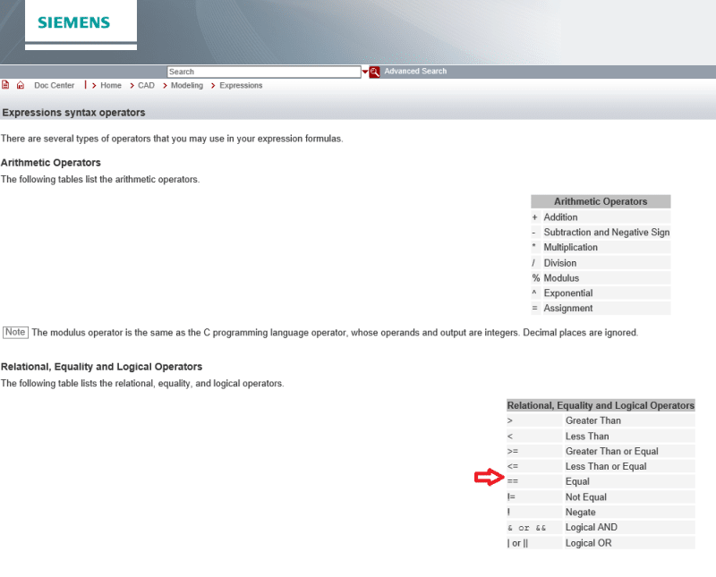

Expressions with double "==" call out or Double "||". Whats the meaning?
3dr
Automotive
Jul 10, 2004
456
Example "==":
if(DIR==L_R)(9*PITCH_ALL)else if(STATION==6)(PITCH_ALL)else((STATION-4)*PITCH_ALL)
Example "||": (OR)
if(SLUG_TYPE==FILLET||SLUG_TYPE==RECTANGLE||SLUG_TYPE==MICKEY)(1)else(0)
I thought I'd seen it all when it comes to these symbols.
I'm in some wizard files and seeing this. Not sure these would be formatted like this.

I am still not sure why the documentation states
"| or ||" means Logical OR.
I have used both variants and both seem to do the same job.
But, is there a difference between "=" and "==" ?
My tests say they do the same or are "==" MUST be equal and "=" SHOULD be equal ? ;-)
I Think the developer had in mind the possibility to use != (Not Equal) Keep it two characters for the condition... :)

NX treats a single or double the same way.
A quick google shows that Java uses "==" & "||"
Could be that they guys making these seed files are just writing in the format they're more familiar with.
Just doesn't matter.

Normally a double equal (==) is used for a comparison check as stated above. If a == b then …
A single equal (=) is used to set a variable to a value. C = 4.5.
Combined, you can write: If A == B then C = 4.5
"Wildfires are dangerous, hard to control, and economically catastrophic."
Ben Loosli
Earlier version of NX required "==" and "||" ... newer versions allow "=" and "|"
