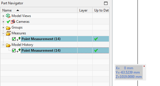

Hi gyus -
I was just testing upfront a comming project...
I need to be able to extract the Coordinates from a Point Measurement Feature in NX...
This should be quite straight forward - but seems NOT to be, for me.....
My approach is to cycle through each feature...
If the Feature Type is "Point Measurement", then simply do the Job of extract Point Value from Feature....
Maybe another approcah can be using the workparts MeasureManager...*???

Hi guys...
Now it works.....
Feel free to have a look at code....
I simply extracted the expression from the Feature....
