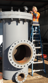

You have to additionally consider that the strainer will have certain maximum pressure drop. I do not think you can keep the pressure drop similar to the equipment you buy with fitting to fitting construction. Have a look at the cross sections that the manufacturers provide. If you try to meet similar design you need either make it very heavy wall or provide sufficient stiffenening. The stiffeners will ne give you adequate spece to operate on them with the same face-to-face distance that the other manufacturers provide. You will end up with a lot higher cost.
You can check the shapes of the strainers below for the discussion above.
We have made strainers from pipe and fittings,. These are designed as part of total the piping stress model.
KevinNZ, this is a basket strainer not a Y-strainer. I agree thet you can assume the components as parts of the piping. The stress analysis will consider SIF s at the nozzle connections which may end-up with higher wall thickness on the body.
