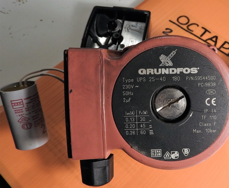

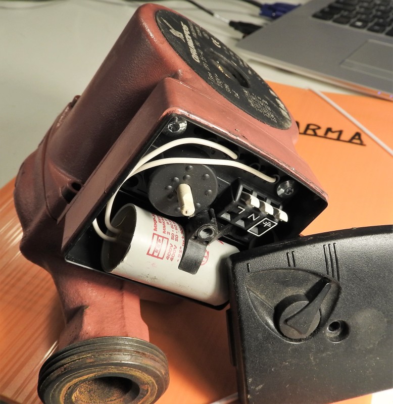

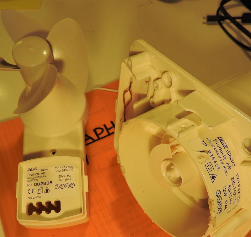

Yes, Bill. SMALL single phase asynchronous motors can - and are - speed controlled by changing the voltage. It has been done for a long time and part of my bread and butter in the eighties and nineties came from designing controllers for such applications. I dug a couple of them out from my garden shed and attach a few pictures. There is also a picture on a circulation pump for heating. All of these motors are very low power and that is what I said in my 19 Feb 17 18:10 answer. The rated Power is from 4 W to 60 W, which is a typical range for this kind of motors.
Zlatko falsely says that ANY asynchronous motor can be controlled that way, which is completely incorrect. I would not even try a 1 HP motor and Zlatko says he can control a 75 HP motor. Which is utterly wrong. To be successful, the rotor resistance needs to be high so that there is a monotone and increasing slip as voltage decreases. Such motors cannot be had and are, hence, not possible to control the way Zlatko says.
