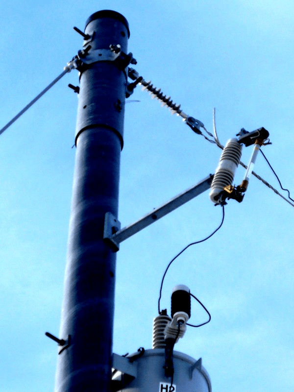

How did you get 2,400/4,160? When I zoom in to the insulators, they appear quite small.
I thought I'd post an example of a small insulator installed on a recently-set pole here in northern Ontario Canada. The system is 12,470/7,200 volts:
That's what I meant when I thought I'd seen some rather slender high voltage insulators, probably some sort of rubber molded around a fiberglass rod.

Does your area have 27.6kv distribution? I know that is really popular in some parts of Canada.
I'm in a wilderness village, and at an age where I don't travel, so I'm not sure about my general area, but my village uses 12,470/7,200 domestic.
Eleanor White
Wilderness village - probably like Elliot Lake or something...there are scads of them, and they're dotted everywhere, although far-flung in many instances...
27.6 kV [ which usually translates into 28 - 29 kV at the transformer station busses due to feeder voltage drop ] distribution voltage is HUGELY popular in Ontario, since there are far less engineering challenges to connecting 16 kV single-phase transformers directly to the feeders. 44 kV on the other hand [ which usually translates into 45 - 46 kV at the transformer station busses ] is almost never used to supply small customers directly, instead distribution stations step the 44 down to whatever distribution voltage prevails in any given area - typically from as low as 4800/8320 to 8 kV/13.8 kV, with a few steel mills receiving power directly at a giddy 8.6 kV / 14.4 kV. The voltage harnessed can often be attributed to legacy installations acquired by Ontario Hydro piecemeal, and therefore without prior standard.
