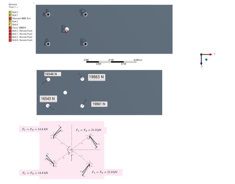

Hi All,
I am trying to compare using FEA results to calculate the bolt forces with the hand calculation from Shigley example... but I can't match it... I extract the forces and also moment... but I am not sure if the FEA results are correct although summation of forces are matching to applied force...
Anyone can tell what I miss out in the FEA?
are you fixing the fasteners for moments ? fasteners should take only shear.
A Major problem you have is that you don't have force equilibrium ... 16 down applied, 20.5 up reacted ???
How to use the reaction moment into the bolt design from FEA results?
No, I mean the little curved arrows at each fastener. The fasteners should not react moments, only shear forces.
But why don't you have a total reaction of 16 kN ?

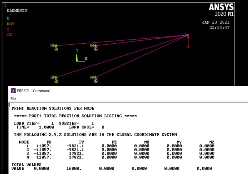

Hi rb1957, I realized a mistake in the FEA results. I upload picture again. The total reaction force is around 16kN.
The bolts near to applied load take up most of the forces...
I re-run the ansys with free the moment at constraints, the reaction forces remain the same... comparing to hand calculation or joint fitting calculation, we transfer the force to the centroid of fitting and distribute forces evenly as well as induce moment...but FEA gives the reaction forces very much different...
The classical solution assumes the plate is rigid. However, from your FEM, you can see it is not deforming in a rigid manner. Are you using a realistic value for the spring constants for the fasteners? This should "soften" the reaction from the fasteners and the plate may deform more rigid-like. If you just grounded the nodes at the fastener locations, that connection may be too "hard" as compared to the classical assumption.

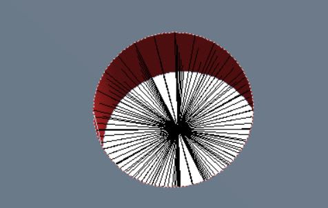

Thanks ESPcomposites, I am using RBE2 with a node at the center of the hole. I run two type of constrains with all DOF fixed and translational fixed only but reaction forces are about the same...
Always start simple. Go for a 2d mesh instead of 3d with fastener holes etc, once you can correlate the 2d model to the hand calc, then go 3d if you really need that level of detail.
Regardless, use a cbush between the mesh and the spc'd node to represent the fastener/joint shear stiffness, and set the stiffness a few orders of magnitude below that of the plate. If everything else is modelled correctly you should see a reasonable correlation between the hand calc and fem.

I shifted the applied force at the centroid of bolts with moment force manually, I can get the reaction forces pretty close to hand calculation...
Does it mean that it does not transfer the moment to the centroid of Bolts in FEA? I understand that usually the bolts near to the applied force will take up more loads...

Sorry but rbe's don't have flexibility.
Maybe I did not say it clearly... I now catch what ESP and you said that in my model, it is not rigid in the first model but in our calculation, we assume it is rigid for force/ moments transferring...
Now I re-run the FEA using RBE3... I can get the same results as hand calculation...

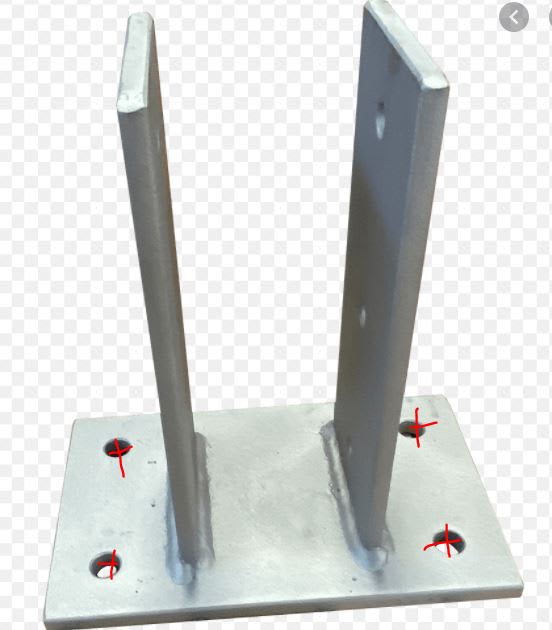

If I run a bracket in FEA, I constrain four fasteners in all 6 DOF... can I take the reaction forces and moments for bolt assessment?
Hi ESPcomposites, do you mean not to constrain the four points directly but consider using spring element there?
1) do not model the fastener holes.
2) do not model that bracket with solid elements.
3) connect the bracket nodes at fasteners to ground or adjacent parts with spring or bar or fastener elements with appropriate fastener stiffnesses.
4) use the spring/etc element results to get fastener loads
don't constrain all 6 dof ... that is (IMHO) being lazy. It is better to constraint 3 (forces) only. It is best to give these 3 dof finite stiffness as opposed to the finite stiffness of a hard constraint.
consider modelling the problem in the same way as you are solving it. constraint 6 dof at the centroid of the fastener pattern, then read the fastener forces at the fastener nodes.
Yes, you should place an element(s) that connect the plate to ground. These element(s) could be springs, a beam, CBUSH, other. Spring elements or a CBUSH will allow you to directly input the spring constant while you would have to "back out" the effective spring constant if you use a beam element. I suspect that a small spring stiffness should give you the result you want (something like 100lb/in or 1000lb/in), but you should use a realistic value as for another check. If you keep increasing the spring stiffness, you will reach a result similar to the one where you grounded the holes originally (aside from the moments that were reacted - but I don't think that will matter too much based on the geometry). While you shouldn't constrain the fasteners to react a moment, its a pretty soft load path and won't pick up much even if you do.
