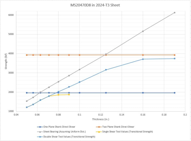

However, I will say, it is odd to me that you have published data with only gives tension and double shear allowables for a Hi-Lok. I have rarely ever seen joint test data for Hi-Loks or bolts in double shear. For example, no Boeing SRMs I am familiar with chapters 51-40-07 or any Airbus SRMs chapter 51-70-13-001 provide this test data.
That being said, there is plenty of double-shear test data for rivets. Examination of that data will show you that in general, double shear values are not simply 2x the single shear value. In a simplified sense (ignoring any deformation of the fastener) that might be true for the shank shear strength (simply because there are two shear planes), but those are only the extreme envelopes of the transitional strength.
Keep in mind a double shear joint can have sheets of different thicknesses. I have seen several sources state, with reference to double-shear strength:
"The strength of a double lap joint is the lower of: 1. Twice the single shear allowable of thickness t1, or 2. the double shear allowable for thickness t2, determined as the lower value of the allowable bearing load of the joint material and the allowable shear load of the fasteners." However, again, I think this is an oversimplification.
For example, we can easily plot rivet test data:
Keep in mind this plot is for the accepted thickness range for this fastener (clearly any thinner and the sheet bearing will be critical, any thicker and the fasteners will be direct shear critical).
But it is plain to see - at low values of thickness the single and double shear values are virtually indistinguishable. This makes sense because with the thinner end of the spectrum, we are close to bearing critical, which is sheet dependent and doesn't really matter if there are two shear planes or not. As the thickness grows, the transitional strength curves diverge from the sheet bearing curve and the single and double shear values also diverge. But the double shear values are not necessarily 2x single shear.
I would be curious to see the values you have for double-shear strength. Do the numbers line up if you simply calculate 2*(pi*(r^2))*Fsu? If so, those "allowables" are not really telling you anything about the joint strength behavior other than the extreme of the envelope.
EDIT: Assuming the attachment was just the datasheet for the fastener... the column of double shear strengths are in fact simply the shank area multiplied by the given shear strength 655 N/mm, multiplied by 2. Whether you cut that in half or not, all it is telling you is the shear critical load. Do not rely on that value. Similarly for the tension number... it is not accounting for things like pull-through, etc.
