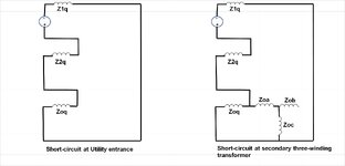

What is the MVA rating of the Yndyn transformer directly connected to the Utility bus?
If the tertiary winding is grounded,Short circuit at secondary three winding transformer  when the teriary is grounded.jpg then the total impedance of the system decreases.
Grounding the delta has no effect on system impedance.
The grounded wye:delta connection has the ability to transfer power from one phase to another.
The impedance seen by line to line unbalances or faults or line to neutral unbalances or faults is less. (whether the neutral is grounded or not)
Grounding the supply side neutral is important because then line to ground faults are also line to neutral faults.
The effect is caused by line to neutral unbalances, whether grounded or not.
