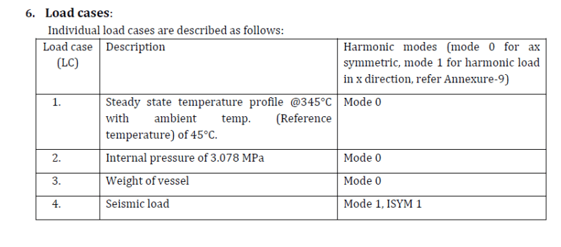

HI all
I am right now doing an thermal Structural FEA of Hotbox(Skirt Shell Junction)in Ansys Workbench. Now I did the thermal Analysis and Imported the thermal profile into Structural. In structural I have to apply Symmetric loading for pressure and Weight but Asymmetric Loading for Seismic Loads using Plane 25 (ISYM=1) elements. I don't know how to approach this problem in Workbench. Please find the attached FEA report and let me know how to approach the Seismic loads ( in ISYM) using workbench.
