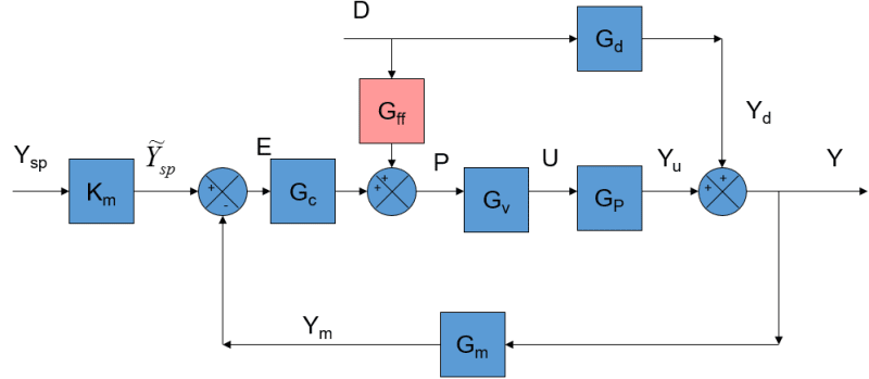

1) "If FF is working correctly there should be no divergence between the setpoint and the output for FB to do anything with."
Thanks 3DDave, and agreed. This is disturbance FF though, ie no setpoint change. FF is the cmd input to the plant. In this case (as in the image) the disturbance Gd acts on the output of the plant Gp. The disturbance causes an unwanted change in Y (with its evolution given by the disturbance dynamics), which the plant will have to compensate for to keep Y at the same constant desired setpoint value. This disturbance doesn't enter through the plant's cmd source.
So, the setpoint remains unchanged for all time.
(This isn't my image, but does show the connection of Gd and Gff to the plant)

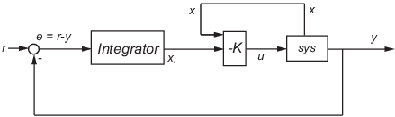

Ah -- a clue finally occurred to me.
There is actually a difference between PID and LQI. They both have equivalent-type correction terms (proportional, integral, derivative), but LQI does NOT use error as inputs to P and D: LQI uses state feedback (which could be from sensors, or estimators). It does use error for I though.
Eg here:
[URL unfurl="true"]https://www.mathworks.com/help/control/ref/ss.lqi.html[/url]
I'm not totally sure yet of the implications, but one thought is that with PID the error gets smaller when FF acts, and that's desirable, so PID doesn't try to cancel FF.
In contrast, LQI looks at the state directly, and if the state deviates from where LQI thinks it should be (eg when FF tries to help the system), LQI will try to cancel FF: since the error isn't a factor here, LQI wouldn't know that a changing state is better or worse...it just knows that it's changing from its desired trajectory.
So, it seems there needs to be a method to tell LQI to not cancel out FF.
Does anyone know of any techniques, or have suggestions?

Now I see what you are getting at.
The closed loop gains can interfere with the feed forwards if the closed loop gain is only used in the feed back path ( act only on changes in the actual position instead of the error ).
Simply put, there are different forms of PID.
The 22 Dec picture shows a I-P controller. There are PID, PI-D,I-PD and different variations where the P and D gains are different in the forward path from the feed back path.
The difference between PID and the PI-D is that the D term is in the feed back path only. The D term only acts on the actual position, not the error between the target and actual position.
The I-PD controller has only the I term in the forward path. This means that only the I term is multiplied by the error. The P and D terms are in the feedback path so the P and D terms only act on the actual position or changes in the actual position.
Feed forwards will only work well if all the closed loop gains are in the forward path like a normal PID or PI. Therefore the I-P controller will not work with normal feed forwards. However, there are other ways of implementing the feed forwards. Another way is to exaggerate the motion of the target position to compensate for the lagging I-P controller.
Gains in the forward path create closed loop zeros. Closed loop zeros can extend bandwidth. Closed loop zeros are also sensitive to noise, coarse feedback etc. Closed loop zeros can also cause resonance peaks or unintentional notch filters. Most people don't worry about the closed loop zeros unless it messes up the response and then they don't know what to do about it. It is possible to place the closed loop zeros as well as the closed loop poles.
To make sure i interpret correctly what you mean by "is only used in the feed back path" and feed back path only: do you mean that that feedback path only is the inner path that doesn't go through the error path? (the error is r-y in my Dec 23 post) I ask because the I-PD has all three going through a feedback path, except (as you said) I is the only one tied to the error.
If that's what you mean, then yes, my update on Dec 23 21:03 shows that LQI is I-PD: only the I path is in the setpoint error path, and P and D are driven directly using feedback of two states x (the two states are pos and vel).

LQI has excellent tracking capabilities, even though they are not acting on the error. My sims do not show poor tracking.
