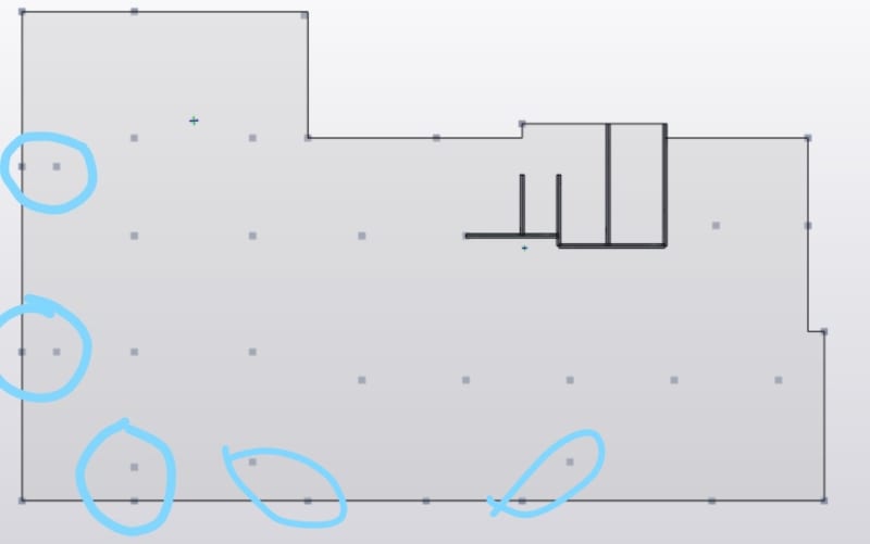

Hi everyone
I am really stuck with the design of a 350 mm thick flat slab (no column drops). The structure is a podium supporting five floors above. As the structure has an irregular column layout, line loads and point loads located in random areas I intend to design it with FEM. I previously did some design of a flat slab but with a regular column layout using FEM. I then used the column/middle panel strip method to average peak moments over the columns so I could specify the reinforcement. In this case however I just don’t know how to apply the strip method due to the irregularity of the column layout as I don’t know how to define a panel width. Maybe you guys know some other method?
By the way I am using Tekla Structural Designer software and below there is a plan view of the podium.
 https://files.engineering.com/getfile.aspx?folder=5f8bb136-e267-4eb3-8832-11d3ce8fbb19&file=Slab.PNG

Have a look at the 'Lines of Zero Shear' method for working out strip widths.
Transfer slabs with irregular grids are one of those things that you will look at it from every which way to satisfy yourself it's strong and robust enough. This would include a nice concoction of FEM analysis, 2D strip analysis and hand calcs.

350mm is very thin for a transfer slab. Don't forget to account for Mxy moment & Shear due to unbalanced moment, especially around the circled area

Most have already specified that, taking a certain width to average out stresses is really an engineering judgement.
This is what I have done in the past where there is a vast change in magnitudes from meshed to meshed area, I select, those meshed areas elements around the column with relatively less gradient in the magnitudes, called out the stresses/forces of the selected areas and then design for an average of stresses for those meshed areas only.
Bubik,
A good place to start is to define your major load paths (orthogonal) in the 2 directions (without a computer!) for the applied loads and associated support layout.
This will show you where your support strips (column strips in a simple flat slab) and span strips (middle strips in a simple flat slab) are.
Overlaying that on your fem result will then allow you to logically associate different widths of the slab Bending moment diagrams to each strip.
Don't forget to account for embedded conduit/pipes and other penetrations. Those could become critical if your design is already borderline.
