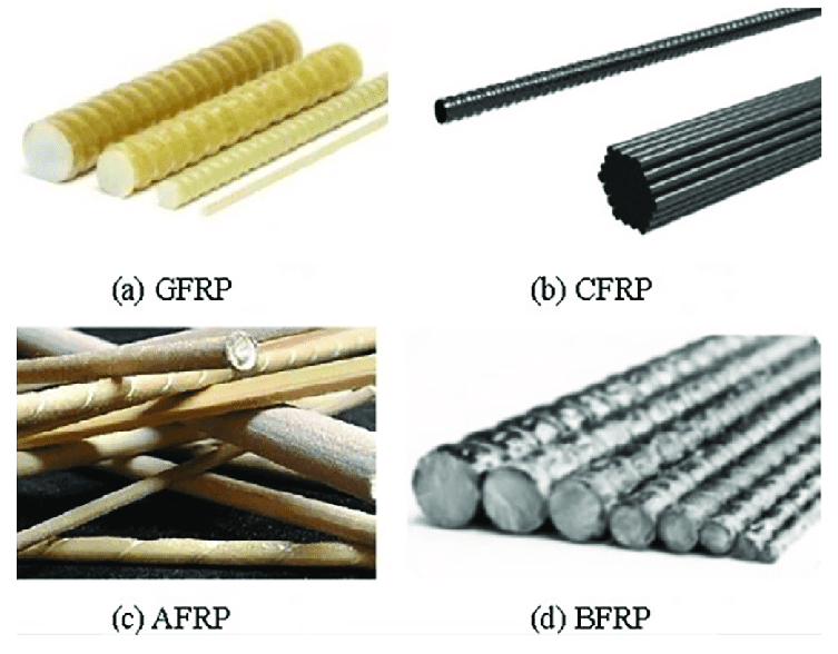

to know the difference just check these numbers
GFRP TYPE = {Cheap relatively} (Glass fiber reinforced polymer)
Ef = 48 GPa [Ffu = 950 MPa]
Es = 210 GPa [Fu = 420 MPa]
CFRP = {expensive ones} (Carbon fiber reinforced polymer)
there advantages ;
Ef = 209 GPa [Ffu = 3250 MPa]
two major companies exist in USA & CANADA
ASLAN & V-Rod
but they quite demonstrated especially in Canada bridges
the other two types are less common [A-FRP & B-FRP]
the Design Code [strengthening] Link
the Design Code [Reinforcement]Link

CFRP is the best type since its behavior (deforms like steel bars <--- cz both have almost same elastic modulus )
add to that Japanese Co. produced [since 1990] a higher Modulus [480 GPa]
Many university & research lab adopted this type in industry
Code of design also progressed greatly
the only draw back is the Cost/meter !
so they tend to be used in expensive project and not residential ones
Ductility achieved through higher concrete compressive like HPC & UHPC [Mostly in bridges projects]

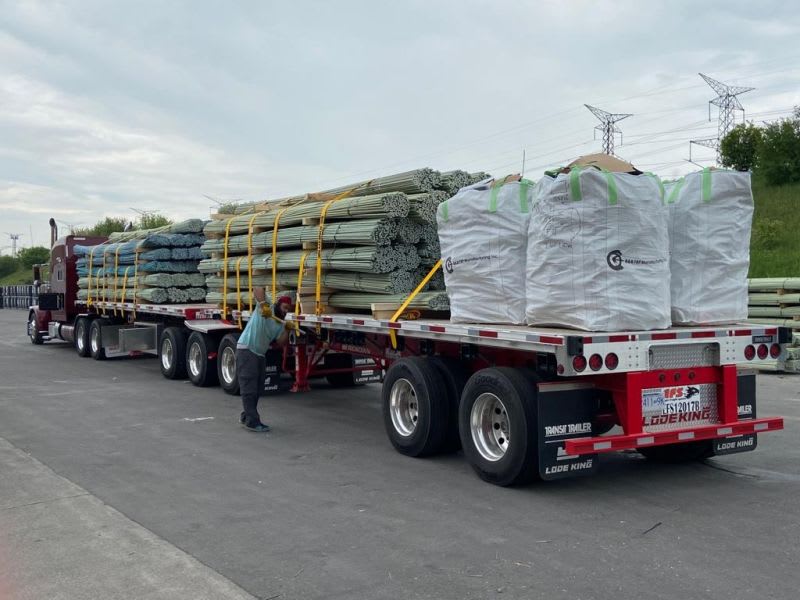

Just as confirmation that these G-FRP Bars are well established in construction industry of Canada
this Engineer periodically publish [on LinkedIn] his projects selling shipments
Link
