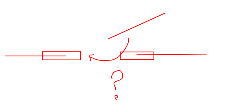

What would be awesome is if there were a two piece mechanical coupler that could accommodate the gap. A lot to ask, I know.

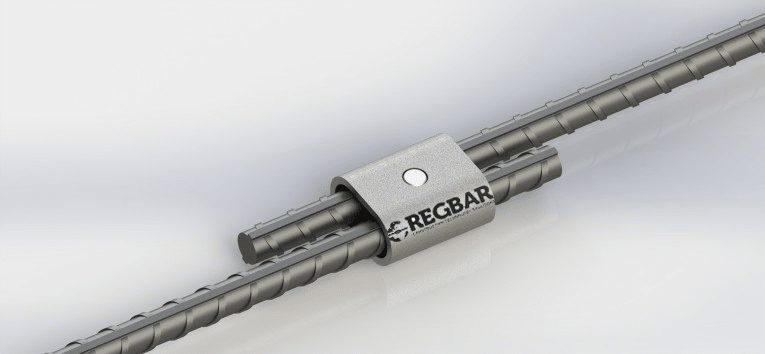

I did a google search and saw a product like this. But, I don't have any experience with it:
You probably better know how to weld to "non weldable" rebar better than I do. I think the issue with welding would primarily be a drop in expected ductility more than anything. Meaning a fracture mechanics issue related to the weld / base material. But, this doesn't look like an application that requires much ductility.
I wonder if these manufacturer's have oversized (over-lengthed?) couplers with additional screws, which would allow for the gap in the splice to not be a problem.
With respect to the sketch below, I see it now. You'd remove enough concrete to slide the sleeves past the existing rebar. Then drop in the new piece and slide the sleeves back to where they need to go.

I did a google search and saw a product like this. But, I don't have any experience with it.
That's not bad actually. Those things don't take up much space in any direction. If they've got ESR reports, that's good enough for me.

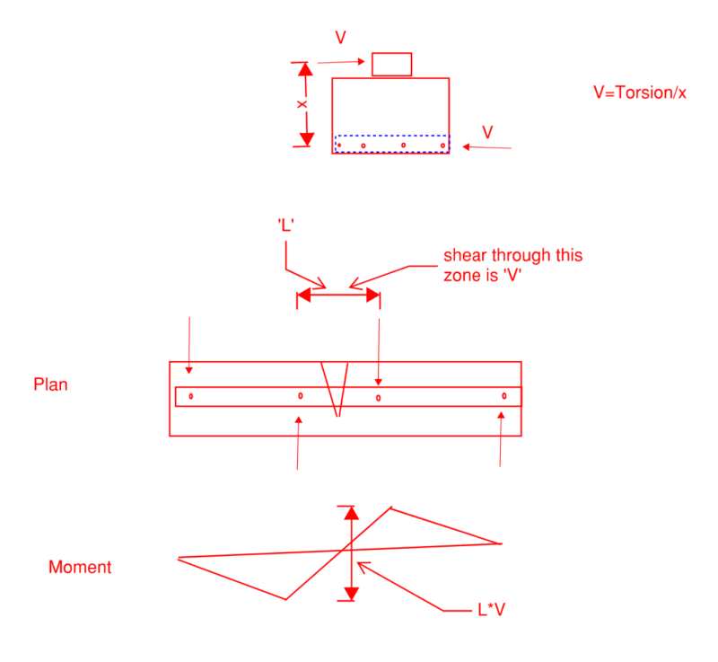

I don't think my wacky torsion idea is a first tier solution, but depending on the load, the deflection may not have an insane compatibility issue given the small span. Issues relating to bolt slop would need to be worked out, though. I think I see unusual torsion load paths in my sleep at this point. Industrial stuff always has some weird torsion load that isn't necessarily big but still needs to end up somewhere.
Yeah, I have my doubts. Outside of those pictures the manufacturer doesn't talk about them much. But, I'm sure you could talk with a technical representative about them.
Heck, even if they don't have ESR's it might be a solution. It's not like welding the rebar would be a great solution either. Either way, you're dealing with something that's a bit outside of "standard practice".

KootK - I meant 1" clear between couplers. So if you had 11" long couplers you'd have an 11" coupler - then 1" gap - then 11" coupler....using a 12" long bar piece in between the existing embedded bars.
Total chip-away area would have to be longer, perhaps 36" to allow the couplers to slide fully onto the embedded bars and allow positioning of the center new bar before sliding the couplers back to within 1" of each other.
Brad805's couplers are much smaller so less chipping.
Why can’t you use a coupler like the one I linked to? It’s off to the side, they list dims in there. You’d have to get the side splice bar loaded onto it, slide it over one bar via a gap, then the other. Too much removal for your liking? Otherwise it seems like it works(ish)
