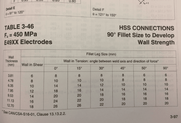

Below is the detail from CISC showing the larger weld that you stated above, Is this a special case only to developing full wall strength?

I am not familiar with CISC, but based on the image posted that table is providing tabulated information of fillet weld sizes required to develop the strength of the HSS. These fillet weld sizes would have been developed by running the required weld calculations.
In general, it is not good design practice (due to it being very uneconomical) to size welds in this fashion (developing the full strength of a member) unless it is actually required. As gtaw stated above, weld sizes should be determined by calculating the required size based on actual forces and comparing this size to the minimums presented in table J2.4. The larger of these two sizes should be the weld that is specified.
Veer007, the table you're showing from CISC is for matching the capacity of the HSS wall if you were to weld something like a baseplate to the end of the HSS. The HSS to base plate weld is creating a T-joint, the max fillet weld size is given for a lap joint. This has been stated in this thread already - you've been given some really good info here and it would be worth it for you to read through it again.

From the CISC table 3-46, this is a T-Joint, also we can use fillet weld size larger than HSS wall thickness and weld size can be exceeded 19mm? Right

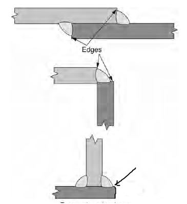

[li]Joint Geometry - A 1/4" fillet weld can be brought right to the edge of plate, any fillet weld larger than 1/4" must stop at least 1/16" from the edge of the plate. Most common occurrence is probably in a lap joint - refer to dauwerda's graphic posted July 7. However, this could also come into play on a T-joint - say you had a cap plate on an HSS and the plate only overhangs the HSS wall by 3/8", your max fillet weld size is 5/16", since a 3/8" fillet would bring the weld flush with the edge of the cap plate[/li]
[li]Neccssity - The weld need not be stronger than required. Refer to the CISC table you posted. If you're exceeding those fillet weld sizes then you're exceeding the capacity of the member and the additional weld is wasteful.[/li]

You could use a 25mm weld on a 19mm plate in a t-joint. At that point, however, it's unlikely that the weld strength will be the limit state that fails. Using AISC, Table J2.5 indicates that you need to check the shear capacity of the base metal for shear as part of the weld design. Thankfully, AISC provides an easy way to check that, by creating a relationship between the weld size and the part thickness. In the 15th edition of the Steel Construction Manual, Equation 9-2 is useful for determining the minimum thickness you need to develop the full strength of a fillet weld. For your 1" weld:
Steel Grade--------Min. Thickness to develop 1" weld
A500 Gr. B---------0.852"
A500 Gr. C---------0.797"
You can flip the equation around, though, and see what the maximum size of fillet weld is for a given part thickness (such as 19mm/0.75")
Steel Grade------Max weld size (16ths of an inch)
A500 Gr. B-------14
A500 Gr. C-------15
Long story short, you can spec the 1" weld on the 3/4" thick piece in a T-weld, but your capacity will be limited by the base material failure.

Veer007 said:
A max fillet weld size should be 19mm.
As long as the size is not restricted by geometry (at edge of plate) as discussed above, there is no code provision that enforces a maximum weld size - you can make a fillet weld as large as you want.
Veer007 said:
t-1/16" is for lap joint only. also, we don't exceed 19mm if it is fillet weld right?
The t-1/16" is only applicable when the edge of a weld can melt the edge of the plate. There is no requirement to not exceed 19mm (other than economy). See image below showing different situations where the weld size is limited by an edge.
Veer007 said:
But if it is T-joint, there is no max weld size, we could use a fillet weld size more than 19mm?
Correct, the code does not limit the size of the fillet weld as long as there is not a geometry issue. However, a T-joint may still have a geometry that limits the weld size - see last picture in image above
