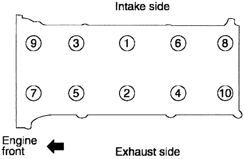

Looking at this again it seems to be that one of your issues is simply a variable pressure on the gasket caused by an irregualar bolt pattern.
It looks to me like you could have at least 6 more bolts in this arrangement to have a much more even coverage, but currently there is a concentration at each corner.
I don't think this thing will ever seal though at 300 psi or even 150, it's just too weedy.
Of course you then need to tighten then up as noted above, by finger tight, 10%, 25%, 50, 75, 100 in a cross over figure of eight pattern,
This is a simple sequence taken from a cylinder head, which is quite similar
