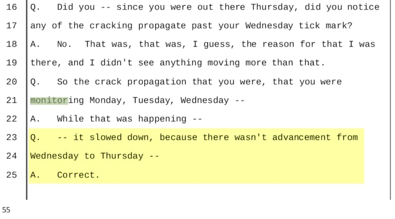

To tidy up my previous post, from the transcript of the Jose Morales' (BPA) interview, page 55,
Although this may be indicative of a steady state being achieved, it needs to be considered cautiously in light of
[ul]
[li]ongoing structural dynamics[/li]
[li]Mr. Morales' memory blank stemming from his injuries acquired as a result of the collapse[/li]
[li]lack of documentation (some documentation is discussed during interviews but I don't recall where, if in fact, it is publicly presented)[/li]

To recap, the slight cracks that appeared on the east/west faces of Member 11 when construction scaffolding was removed became more pronounced upon bridge placement (photographed by FIGG, Mar 10, noonish), became alarming prior to detensioning (photographed by Morales, Mar 10, 3:30 pmish), progressed while monitored the next few days though ceasing by Mar 15 (vague as to time of observation). Much of the discussion regarding the cracks is muddied (including in the WJE report) by references to when photographs were sent/received rather than when (or temporal context of when) they were taken, an important distinction in terms of structural or legal dynamics.
