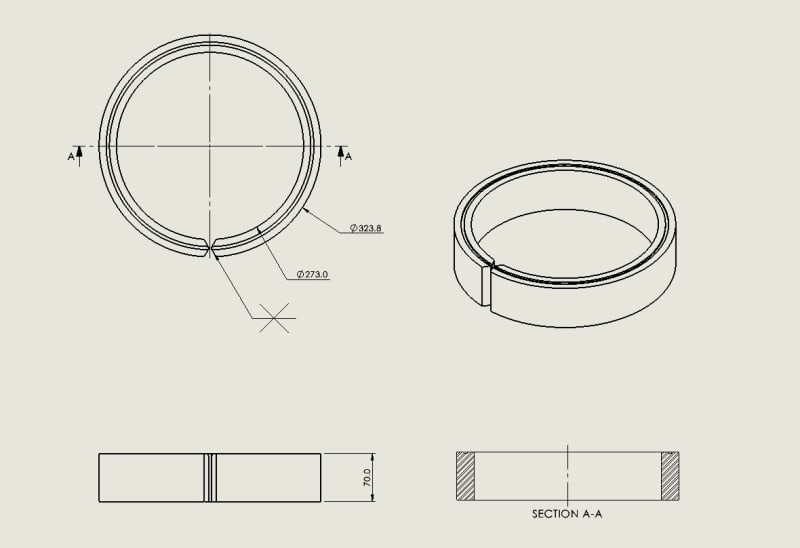

Hi Everyone,
I am just wondering if a flange ring can be manufactured from a pipe or round bar and still comply with ASME VIII rules? If not, can a flange ring be rolled from flat plate or bar and then welded? What are the requirements for the weld?
And the code is????
Some sketch?
Regards
Sorry for that. The code is ASME VIII Div 1. I read UG-14 yesterday and I believe that round bar is allowed to take function as flange ring and material grade suitability needs to be checked in Section II. I could find nothing about the flange rings machined from a pipe. I have attached sked of the rolled and welded flange ring I have got in my mind. The flange ring is of 30 mm widths and 100mm height, diameter to suit.

The reason for this is that I have found a 12'' pipe SCH XXS which with a little of machining on its I/D it will be perfect for my application. The design must comply with ASME VIII Div 1.
Thank you for sending the link to interpretation. In this case, the flange ring is not a hubbed flange so I think this is not applicable. The flange ring is welded onto 10'' pipe shell and has an o-ring groove machined on the mating face. By saying 100mm height I mean the overall thickness of the flange ring and I/D is slightly bigger then 10'' pipe O/D. Because of the ring flange thickness being 100mm it would be much easier for me to get a piece of pipe, cut it to suit and machine to proper O/D & I/D. If I can't do that, can I roll a plate to the ring flange O/D and then weld the ends?

Some Curious Guy, thank you for your reply on my second question. I have checked this paragraph so I believe the joint efficiency E for this weld is to be set in UG-34 accordingly in order to calculate thickness of the ring flange. I haven't seen any design where a piece of pipe is used as a ring flange but in my case due to geometric requirements that is quite efficient. Shell O/D is 10'', the pipe I can get utilise for the flange ring is 12'' SCH XXS which is 25.4mm thick and the I/D same as 10'' pipe O/D. I have checked the calculations for this type of ring flange attached to a shell as 'loose' flange and managed to figure out the minimum required thickness in accordance with formulas in UG-34 sketch j) and appendix 2. This design is to accommodate swing bolt brackets with PCD outside gasket reaction.

UG-34 is for blind flange not a ring type flange. In your case you have to find the governing thickness as lesser of flange thickness t or ( A-B)/2. Notation are as per Appendix 2. Refer para UW-11 for radiography requirements. All this is clearly given in Appendix 2-2(d).
Appendix 2 has been used for design of Swing bolt flanges before with flange OD A as defined nomencleature 2-3.
I agree with others to request you to provide a sketch. Your Flange looks a tiny bit unusual in construction and might need some extra calculation apart from Appendix 2.

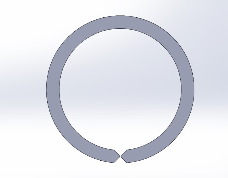

Sorry for delay, I have just got this drawn.
This is a photo of rolled of welded ring type flange. Alternatively, the dimension show there corresponds to 12'' SCH XXS which could be used as starting point for similar ring flange if for example I/D if this pipe is machined to suit.

r6155, sorry mate but I don't get what you need. This is the drawing of the ring flange. You can now imagine for an example a blind flange with slotted holes goes on top of that and swing bolt brackets welded to the ring flange. It is simple as that.

mech8790, if using the rolled ring as shown I'd RT the weld seam even though Apx 2 does not seem to require it. Just good practice.
Given that, I'd guess the pipe section would be more economical. As I said before Code does not prohibit it.
Perhaps you saw this discussion of a similar design.
Regards,
