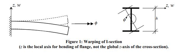

2) A torsionally fixed restraint has the features of #1 but also goes an important step further by adding cross section warping restraint. You know how we assume that "plane sections remain plane" for normal, strong axis beam bending? In order to have warping restraint, you basically need plane sections to remain plane about the weak axis at the restrained support as well. In the sketch below, that is the case at the left end of the beam but not at the right.
