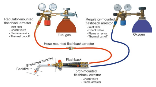

Now the pressure regulator gets attached to the 200 bar H2 cylinder. The flexible hose (typically 1/4'' inner diameter tubing) then gets attached to regulator. For applications involving welding, cutting ect. you would install a flashback arrestors (also known as flash arrestor) between the hose and the regulator; the idea being it would stop the reverse flow of gas as well as flash back into the regulator and the cylinder itself.
Now the pressure regulator is rated for a cylinder pressure of 200 bar (P1), where the working pressure (P2) can either be 1-10 bar, or 10-200 bar. The highest rated flashback arrestor for this application (to my knowledge - and after asking multiple distributors in my region (Europe)) is for a working pressure of 17 bar, and the cost is sky-high.
I now have a customer (plant manager) that wants a flashback arrestor rated for 200 bar H2 fitted between the flexible hose and the pressure regulator.
Now the pressure regulator is of course equipped with a pressure relief device in case of failure. But I have never before seen or heard anything about installing a 200 bar flashback arrestor between a flexible hose and the pressure regulator mounted on the H2 cylinder. It just hasnt been done before to my knowledge. In the words of one of the distributors I reached out to: a flashback arrestor with that spec has never been, and will never be, manufactured.
Now my question is this: Has any of you ever heard of such a thing? Are there any rules and regulations in place (Europe) I'm not aware of? In my experience so far every customer that uses H2 for cutting and welding uses a 200 bar cylinder, with a mounted pressure regulator with a working pressure between 1-10 bar, with a flashback arrestor if needed. For higher working pressures than 17 bar, no such equipment exists...

Flashback arrestors should be installed close to the point of flashback ie in this case, close to the welding torch. This is where the reverse flame front velocity is lowest. The further upstream the reverse flame front gets to travel, the faster the flame front velocity, and then the flashback turns into a detonation with very high velocity. Installing a flashback arrestor close to the H2 cylinder cannot stop the reverse flame front, and is bad practice.
If the flashback arrestor is good for 150psig only, install 2 regulators in series, both with setpoint of say 100psig max. The first one being a monitor regulator. Talk to regulator vendors about this.
georgeverghese: and for applications with welding torches you would as you say, have a tourch-mounted flashback arrestor (check valve + arrestor) with a hose mounted arrestor AND a regulator mounted arrestor. Which is fine because the working pressure is usually no more than 10 bar (sometimes upwards to 17 bar).
Now the question is what is usually done when the working pressure of hydrogen is more than 17 bar? Let's say the hydrogen has a working pressure of 90 bar, and is mixed below the LEL; a sustained flashback would not occur, correct? But what if the mixture is above the LEL?
1. Is that a likely application? If so, based on what you are saying, a flashback arrestor at the outlet of the regulator would serve next to no purpose as it cannot stop the reverse flame front.
"The further upstream the reverse flame front gets to travel, the faster the flame front velocity, and then the flashback turns into a detonation with very high velocity" - Could you please explain how the reverse flame velocity increases the further upstream it travels? I must admit I know very little of combustion mechanics - (As a side-step: any literature pointers would be greatly appreciated as the subject is fascinating).
That adds up to 3 arrestors in series - the one upstream at the regulator is of no use, since no flashback arrestor will work at this location.
If the H2 mix is well below LEL, then the flame front would extinguish itself. If the mix is above LEL, the 2 regulators in series would be a must when pressure exceeds the design pressure of of the arrestors.

georgeverghese: correct, and there you have it, EIGAs own recommendation for torch applications...
Thank you for info, and the attached file! Interesting read and greatly appreciated!
