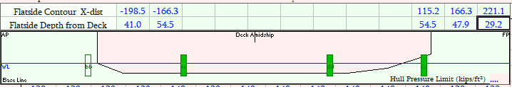

I'm using OPTIMOOR for dock design. I have Q88's for all of my vessels, however, I cannot find any information on the hull shape. Specifically the flatside contours, both X-dist and depth from deck. Does anyone know where I can find this information or if there are standard values or equations I can use? My vessels are one product tanker, two Panamax tankers, and one Aframax tanker.
IRstuff I am specifically looking for flat side contour information, so forward and aft fender limits. Basically the lengths and heights of the portions of the side of the ship that are flat and can therefor be counted on to contact fenders.

Yes the Q88 gives parallel body lengths but it doesn't give the depths, the picture I posted above gives the required inputs. I'm currently assuming 80% of the moulded depth.
Seems odd that the Q88 doesn't provide you with the information; how else would the average dockmaster know whether a ship coming into port is compatible with his docks and dolphins?

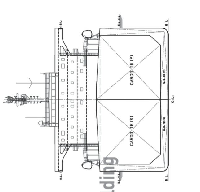

Sounds right. The people I used to work with who did optimoor hoarded every tidbit they came across. Body line drawings don't find their way to structural engineers very often for some reason. Those optimoor people also relied on web searches and some pretty broad assumptions, justified by optimoor (or any static mooring analysis) being pretty rough.
Here's an aframax I have a midlength section of:
And a 37,000 DWT product tanker:
Boxy but good.
I don't think there is any standard relating to this - it seems to be a ship specific set of drawings. Your 80% of LOA looks OK to me, but there is some considerable differences between different vessels especially at the aft end in terms of section through the vessel and also longitudinal section.
You need both plan and section to find out.
