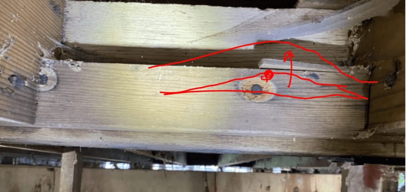

I have a project where I have to calculate the capacity of an existing wood framed floor (should be simple enough). I made a visit to the site yesterday and took a few photos and took some measurements. I noticed that all of the floor joists were notched in order to rest on a flush framed wood beam (see photo).
The notches on these joists is over the allowable notch located in the building code (which I believe to be 10% of the overall depth of the wood member). NDS does give an allowable shear equation for notches of fv = [3V/2bdn][d/dn]. Using this equation I am calculating an allowable end reaction of 154# which gives me next to nothing in capacity for the floor (17.5 psf).
I know this method of construction was used in the 1970's (my parents house has this exact detail). Question is, do I ignore the detail based upon it's the historical use of the detail or do I report the capacity of the floor as 17.5 psf? I am leaning towards the 17.5 psf as it's really not my problem to deal with at this time.

It appears they're spiked into the ledger, so the 154lbs is probably a very conservative estimate, but a reasonable one. If the use isn't changing, then I would warn the owner that it can technically continue in service under the existing building code, but it is not a reliable condition and these are prone to fracture (assuming, of course, that your state has similar EBC provisions to mine). Look for any that appear to be splitting (even just a little) and have them repair those, at least.
If they are changing the use, then 17.5psf is your new capacity and you need to upgrade all of the connections if it needs to increase.
and a ledger connection fastened below the beam neutral axis, is that reliable given the tension induced perpendicular to grain? I see this type of joist ledger used all the time around here to save a few bucks on hangers, and always think it's a bad detail.

Based on the current NDS code, I'd say that the capacity is zero. The notch exceeds 1/4 the depth, which is not allowed, per Section 4.4.3. And "heavy or medium concentrated loads shall not be suspended below the neutral axis..." per Table 12.5.1C, Footnote 2. I would just leave it at that, because if you tell them it's good to go with 17.5 psf and then there's an issue, how will you justify it?

Piggybacking on bones206's concern for fastening below the neutral axis, the worst version of that here may actually be in the ledger block rather than the beam per the sketch below. Kinda depends on where the joists land relative to the ledger fasteners.

This was done back in the day, it's still in the code (see 2021 IRC Table 602.3(1) I know, Wall Construction, bear with me). It's item 29 in that code. If you prefer a more graphical depiction, look in the ISANTA ESR-1539, Figure 12E.Link Thing is, at least in the ISANTA graphic the joist is supposed to bear on the ledger strip and the flush header (girder?) is supposed to be deeper. Sure it goes into shear that tends to try to split the wood apart, but it's permitted.
In an engineering sense, this is difficult to justify (as has been stated above), and what is on the site doesn't actually meet the code (nailing is missing/not spaced the way the code currently wants it, nails appear to be maybe even cut nails (bolts?), and there's that deep notch in the joists. The construction technique looks like 1940s yet the wood isn't rough sawn. I guess maybe it's "nice" rough sawn? You could maybe palm nailer and get some A34 clips each side of the joists? The two joists you show don't look like they have already split, and if the load isn't transferred by bearing on the ledger strip, the split shouldn't develop in the future?
I thought that ledger looked "too wide" but I guess they want 2x2 minimum (2021 IRC R502.6.2)

What is the actual depth of the joist and the notch? Picture kind of implies the joist is bigger/ taller than the cross beam?
Is that a wedge or shim on the right hand joist under the notch?
The condition looks remarkably good - no splits, dry rot or water?

Those connectors look like they were screw bolts driven in and then someone has cut off the heads to allow the joists to fit?
What's on the other side of the supporting beam?

So in the end, I ended up going back and giving them the allowable loads for the floor based upon the different failure modes. This detail actually did not create the lowest failure mode. That belonged to a post that was bearing on a beam that was supporting 1/4 of the attic and generated an allowable floor load of 0psf. Definitely some issues on this project and I wasn't happy with the architect for bringing me out here to waste my time. It was a new client (warning sign #1) who does a lot of work with a competitor (warning sign #2) and another engineer was in here a few months ago doing some shoring work on the floor..... but they couldn't help the architect with the loading question he was asking (warning sign #3).
In regards to some questions above.
Yes, the joists are higher than the main support beams
Yes, it looks like they shimmed that floor joist.
There were some brand new Timberlok lag screws installed on some of the ledgers (see warning sign #3 above).
