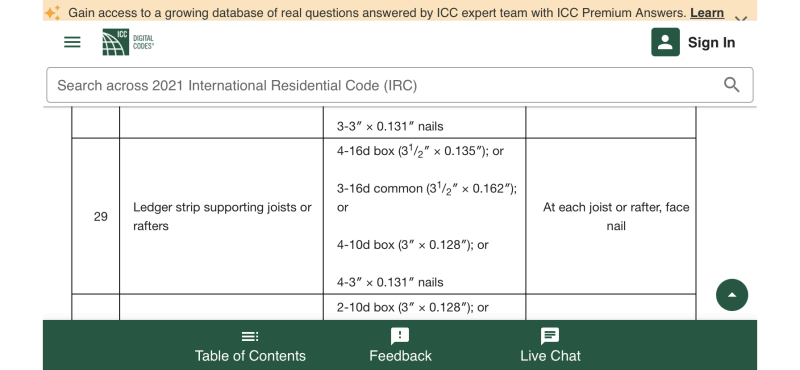

The IRC calls for four nails at the ledger doesn't it?
There are different fastener options in the table. I just went with the 3 spikes for my example.

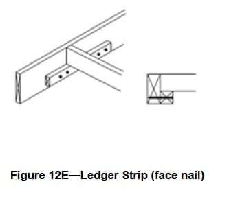

lexpatrie - is that out of your state's version of the residential code? I know North Carolina replaced the standard fastening table with a neat version that has pictures, but all the other states where I practice still have the plain text version. I like the pictures...contractors around here are really good at "interpreting" those tables in ways that invalidate my designs...and it usually happens with the inspector while I'm not there.
That's from the 2021 "base" International Residential Code, as I recall. The figure is from the ISANTA ESR. There's probably similar in the ICC Commentary to the IRC, which is perhaps where the North Carolina code got their figures? I hope they match fairly well.....
NC is still on the 2018 codes and will be for another 10 years (at least for the IRC). 2021 IRC still has the text tables, too. I hadn't seen the ISANTA ESR before - thank you for you pointing it out. Those are the graphics that NC used in their edited tables.
