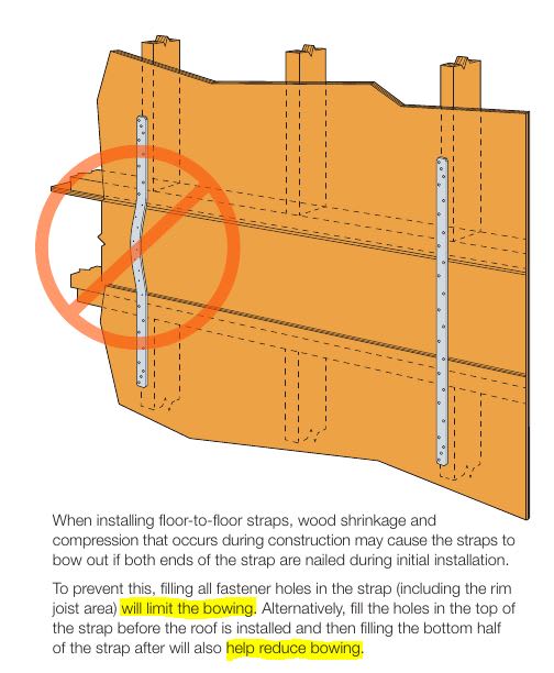

FYI Simpson has a footnote on the CS16 straps
"Wood shrinkage after strap installation across horizontal wood members may cause strap to buckle outward."

No, they have a sheet in the catalog that explains you have to wait until shrinkage is done to fasten the bottom end, fasten in the floor band to restrain the buckling, or both.

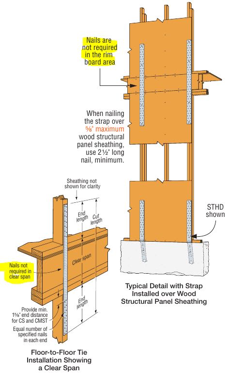

"The straps are nailed top and bottom and not at the floor system as specified by Simpson.", be careful with this statement Simpson's catalog specifically notes that attachment along the rim is not required so it falls to the design professional to specify that. Edit: I read your statement as saying Simpson specifies nailing at the floor system but reading it again could be interpreted as intended by the snipped detail, so just a word of caution either way.
The catalog has recommendations to "limit" / "reduce" bowing by either nailing along the Rim or attaching the bottom of the straps after the roof is on:
The graphic that Celt posted is exactly what should be done. Use all of the nail holes or install half the strap first then come back and do the bottom half next (which is what I see most often). Shouldn't be any bowing in the straps.

I was hoping there was published tolerance with the straps but it seems that any bowing is not acceptable. Im gonna tell the contractor that all the straps need to be re-installed.... which is a big undertaking for this project..
For future projects, I will have the above install instructions on my plans.

I disagree that "any bowing is not acceptable". I don't think that is what Simpson is saying. They are making recommendations to reduce the likelihood and severity of buckling of the straps, but it may still occur, especially if you just wait to nail the bottom of the straps and don't also nail the strap at the floor cavity. Ultimately I think this is "just" a serviceability issue, otherwise I think Simpson would take it more seriously. In my opinion, it probably does not matter whether the straps buckle or not, except that the straps buckling might cause localized damage to non-structural finish materials, which, granted, could result in a fairly serious problem like the one phamENG described.
If you wait a few weeks to nail the straps, that might help, but I would expect the majority of shrinkage to occur over a longer period of time after the building is completed and put into service. I think nailing the straps across the floor cavity would help by forcing a different pattern of deformation of the straps, but they still must deform because the shrinkage will still occur, so there still will be slack in the system, which must not be a problem for the strength load case.

I am not aware of any guidance for a buckled strap beyond the warning that buckling can happen after wood shrinkage in the installation notes found on page 283 of the C-C-2024 catalog and guidance to follow to avoid the buckling due to wood shrinkage located on page 51 in the High Wind Guide.
I did reach out to the Simpson product engineer assigned to the CS product lines and he provided this information for you to consider.
We don’t have guidance on how much bowing is too much. The strap bowing would not create a strength limitation on the connection. But the load wouldn’t get transferred into the strap until the slack is taken up, so there may be some additional deflection. Designer would need to evaluate that based on the size of their bowing and floor geometry. As long as it’s less than ¾” of bowing, it doesn’t seem to create much additional deflection.
