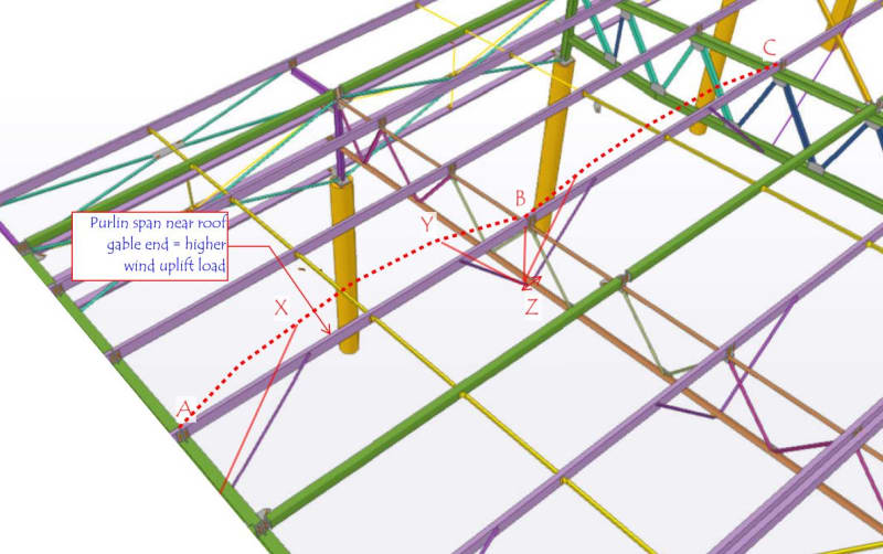

Hello,
I participate in a Whatsapp group with some engineers of my region(Brazil) and one of them said that he uses fly brace to reduce the span of the purlin. He introduces the fly brace on the software and the purlin acts as a continuous purlin.
I said that consider this wrong because the bottom chord of the truss is not adequate to receive the horizontal load and that he may introduce torsion on the truss, but he doesn't believe it because the analysis show no problem when he introduces the fly brace and the purlin, who otherwise fails, pass.
I think that the loads are balanced and the horizontal loads are absorbed by the opposite fly brace and suggested, without success, that he analyses the model with live load on only one span.
What do you guys think of this?
I've seen that a lot of the engineers on the group agree with him and do the same.

Human909 is correct. I'm sorry for creating the thread and disappearing but i was too busy on these last two weeks. I created a model to check and, for the purlin, the balanced situation is more critical than the unbalanced. The Fly rafter reduced considerably the bending moments and displacement of the purlins.
Thanks Guys.
Thanks for running the model and showing the significant reduction in bending moments and deflection.
I'll likely still be safely ignoring my fly braces in my models and considering only as flange restraints. That said I do believe this is a good exercise. You cannot always safely ignore redundant load paths. In some cases taking what you might believe is a conservative assumption may cause load to go where you don't expect it causing issues in strength or deflection criteria.

I don't think you can have it both ways.
Either the truss has sufficient lateral torsional rigidity to provide support to the purlin in bending or the purlin has sufficient flexural stiffness to support the truss for LTB.
The fly brace is just an axial link.
You can't have your cake and eat it!

human909 said:
When you have a double fly brace the rafter/truss doesn't need lateral torsional rigidity.
That is true if the purlin has sufficient stiffness and acceptable vertical deflection spanning between points A & B.
If the purlin doesn't have sufficient stiffness spanning between pint A and B then the truss bottom chord should not be considered as laterally braced on point Z.
The statement below by OP's colleague implies the purlin span between points X & Y. I don't think that is entirely true, but I agree that, for uplift load, the fly brace acting in tension could help transfer some of the load from the purlin spacing between points A-B to the adjacent purlin between B-C.
These two stiffness requirements are not directly correlated so such an assertion cannot be made.
I won't respond with alternative definitive statements because so much depends on the individual circumstance. Once we start dealing with continuous purlins, dual fly braces as supports and multiple bays we have a quite a complicated statically indeterminate system.
But what I will say is that you analyse the structure in a rational way with a reduced span of the purlins by accounting for the purlin load that the fly braces support. Whether this is a worthwhile approach is another question which I believe I've already commented on.
