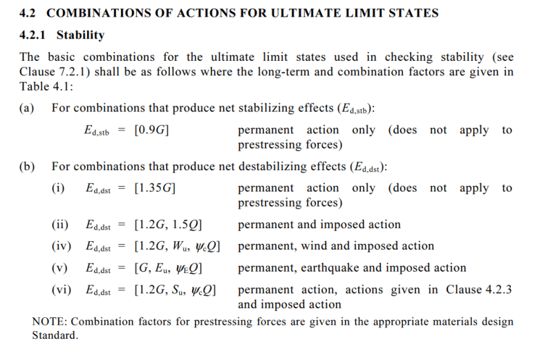

I have a relative simple question in regards to footing design
Given the allowable bearing pressure. What combinations do you use to check the stability when lateral loads and moments are involved?
For gravity I can do G+Q but I don't know what load combinations do I use for wind & earthquake?
Or do you times a factor to get ultimate bearing pressure? If so, where can I find clauses that allow us to do so?

Sorry I forgot to mention that I am designing to Australian Standard where I couldn't find such ASD load combinations. I want to check overturning & stress but looks like load combination for stability load combinations are for ultimate only.

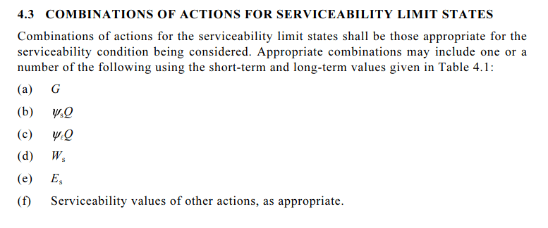

Pardon my ignorance on limit state design approaches, are there different sets of load combination for strength limit state and service limit state?

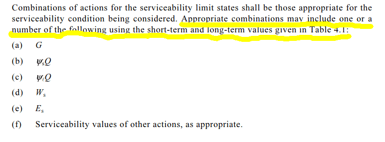

Serviceability Limit States are the equivalent to ASD load combinations, loosely speaking. AS1170 CL4.3 includes load this which needs to be read with Table 4.1
Is there any factor that we normally will use to times the allowable to get ultimate? I have heard 1.3-1.35 is used but don't know where this figure comes from..
For soils, you'll need to check with your Geotechnical Engineer. They're notoriously conservative when it comes to safety factors, I think the FOS for allowable and ultimate soil bearing capacities is anywhere between 3 - 5 typically.
I am confused. If serviceability limit states is equivalent to ASD, then lets say for gravity, what combination will you choose from serviceability limit state? From what I know, there are G+0.7Q for short term and G+0.4Q for long term. But don't we normally use unfactored G+Q to compare with allowable bearing pressure? And for wind load, what combination do I use here? If I use G+0.4Q+Ws for checking the stability, won't it be 'dangerous' because I am using the Ws instead of Wu? (I understand that ultimate bearing pressure is greater than allowable one but we not only reduce the load combination factor here but also the value of wind). And for earthquake, I believe most engineers will perform ultimate analysis. I have rarely seen Es used.
The minimum safety factor is at least 2, and up to 3 - 5 as addressed by Medeira. The key words to the service limit state combination is underlined below. The list given the individual un-factored load case to be considered, but there are many combinations that are possible, depending on your situations. For example, for gravity LCG = (a)+(b), or (c); for wind, LCW = LCG+(d); for seismic with/without wind LC = LCW+(e), and LCG+(e). Since I am outside of the country of your practice, please do check my statements with engineers knowledgeable on your standard.
Standard guidance as found on page 71 here:
(a) Dead load 1.35G
(b) Live load(i) 1.2G + 1.5Q
(ii) 0.9G + 1.5Q
(c) Wind load
(i) 1.2G + Wu + wcQ
(ii) 0.9G + Wu
(d) Earthquake
(i) G + wcQ + Eu
Note the 0.9G which is can be pretty critical for overturning critical condition. Obvious this is more important for tall, lightweight and slender buildings subject to wind loads. In general I find the key criteria are generally, deflection, 1.2G+1.5Q and 0.9G + Wu. Seismic in general doesn't exceed the latter two, though it can for storage or industrial type structures.

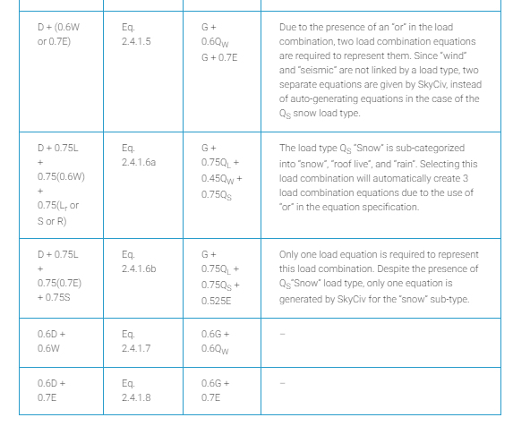

My understanding has always been that the short term loading reductions are not applicable to footing design. So it is
G + Q
G + wcG + Ws
G + wcG + E
G + Ws
G + E
Not sure why people are defining Ultimate Load Combinations for a service stress design.

Standard guidance as found on page 71 here: [URL unfurl="true" said:
https://wiki.csiamerica.com/download/attachments/7...[/URL]
(a) Dead load 1.35G
(ii) 0.9G + 1.5Q
(c) Wind load
(i) 1.2G + Wu + wcQ
(ii) 0.9G + Wu
(d) Earthquake
(i) G + wcQ + Eu
Note the 0.9G which is can be pretty critical for overturning critical condition. Obvious this is more important for tall, lightweight and slender buildings subject to wind loads. In general I find the key criteria are generally, deflection, 1.2G+1.5Q and 0.9G + Wu. Seismic in general doesn't exceed the latter two, though it can for storage or industrial type structures.]
I believe these load combinations are for ultimate bearing stress not allowable one?

One question I have here is do we really use Ws instead of Wu here for stability check? I know that some people use ultimate combination (with Wu) and then times allowable bearing pressure a factor, which is about 1.35 to get the so-called ultimate bearing pressure to check stability. ie. 1.2G+0.3Q+Wu <-> 1.35*(allowable). So if I use G+0.3Q+Ws <-> 1.0*allowable. Looks like the later one is more aggressive because roughly Ws<Wu/1.35.
Also, for Earthquake E here, what is the service earthquake Es? Normally we just perform the ultimate analysis.

I don't get this. The earthquake action in As1170.4 should be ultimate Eu. How do I get the service one Es in AS1170.0?
Ey2,
I don't know if this helps, as it is an US design example. However, it may resolve your confusion on this issue. Link
